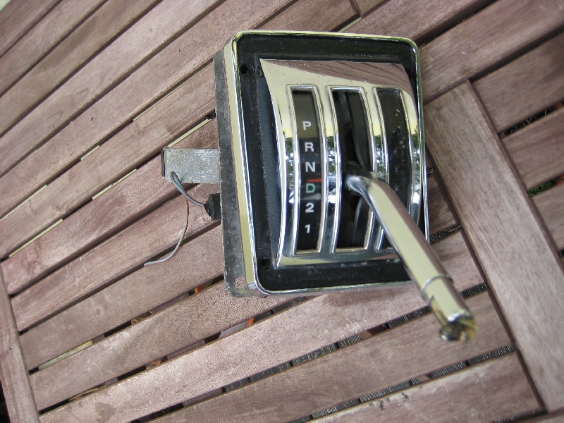

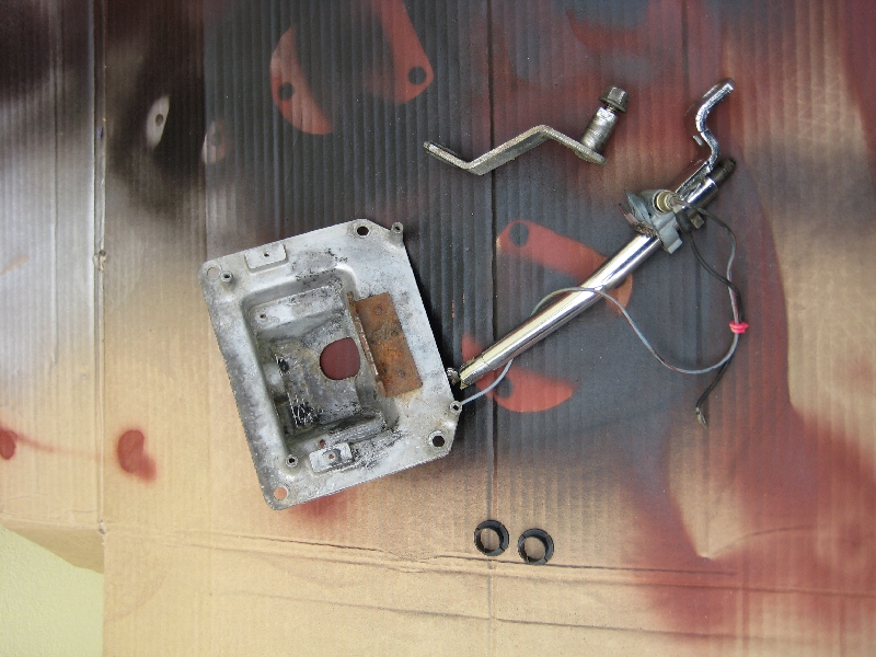

    finally got a shifter that fits - a 69/70 mustang one.
    rebuilt it today and completely removed the shifter wobble with new bushings.
    i'm just not sure about the handle. i've got the chrome one, and a walnut one with a cobra insert. just can't decide which one to take!
    do we need a tech article on the shifter rebuild?

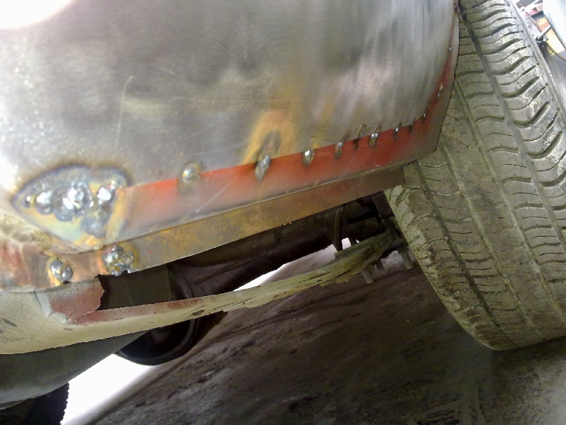

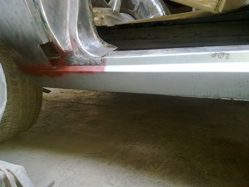

    the first steps in the bodyshop were done last week. here's a couple of impressions:

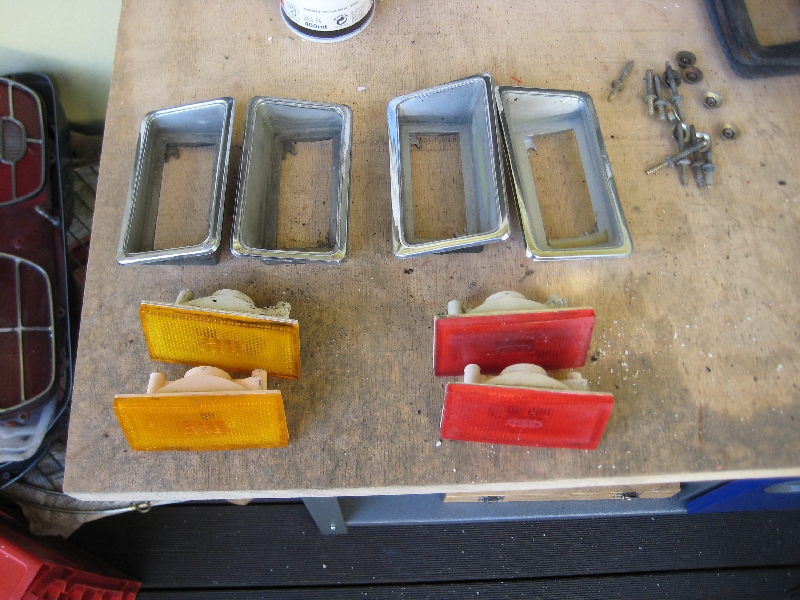

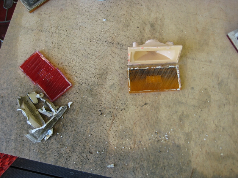

    the progress is awesome! good work on the lens, that's pretty meticulous
  6. mav1970
    The true craftsman comes out in someone who can't just jump in their car, drive a few miles to a junk yard, and pick up another side marker light.
    Nice job :bowdown:

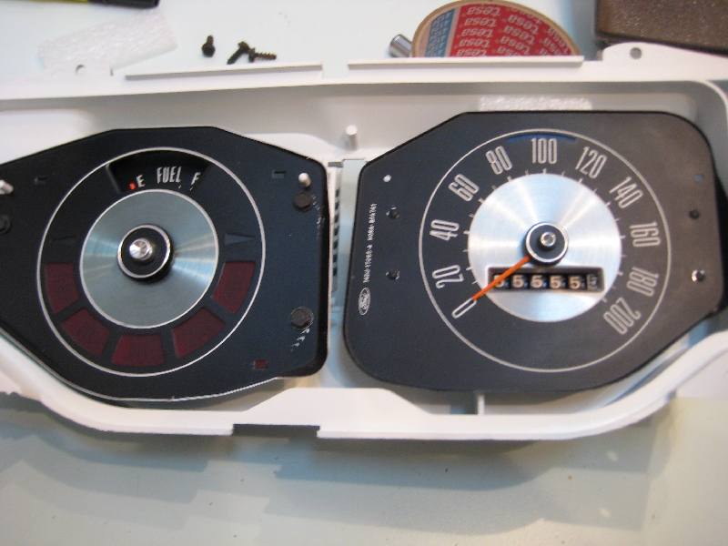

    ok, here's even more news!

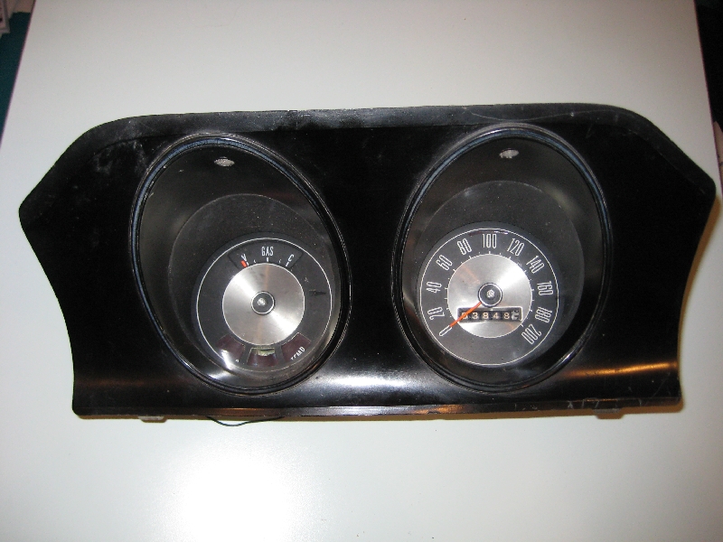

    my brazilian tach arrived today. the front looked good, but the printed circuit on the back is a mess. so i need to use the remaining american parts and take only the brazilian speedo. not as easy as i would have thought, there are some differences.
    the outer dimensions are identical, but the speedo mount is different - vertical on the american version as opposed to diagonally on the brazilian one.
    mix matching the parts will somehow work, but the mounts for the fuel gauge are different, too - the american version is wider. but i guess i'll be able to dremel that. there's more minor differences, such as different positioning and labeling for the idiot lights.
    the remaining question will be - is the speedo cable going to fit? brazilian version is screwed on, american version is mounted with a plastic clip. i'll let you all know...
    here's one pic of the whole unit, more pictures on my website:
    http://www.72comet.de/gt/index.php?id=56

    and finally - my kph tach!
