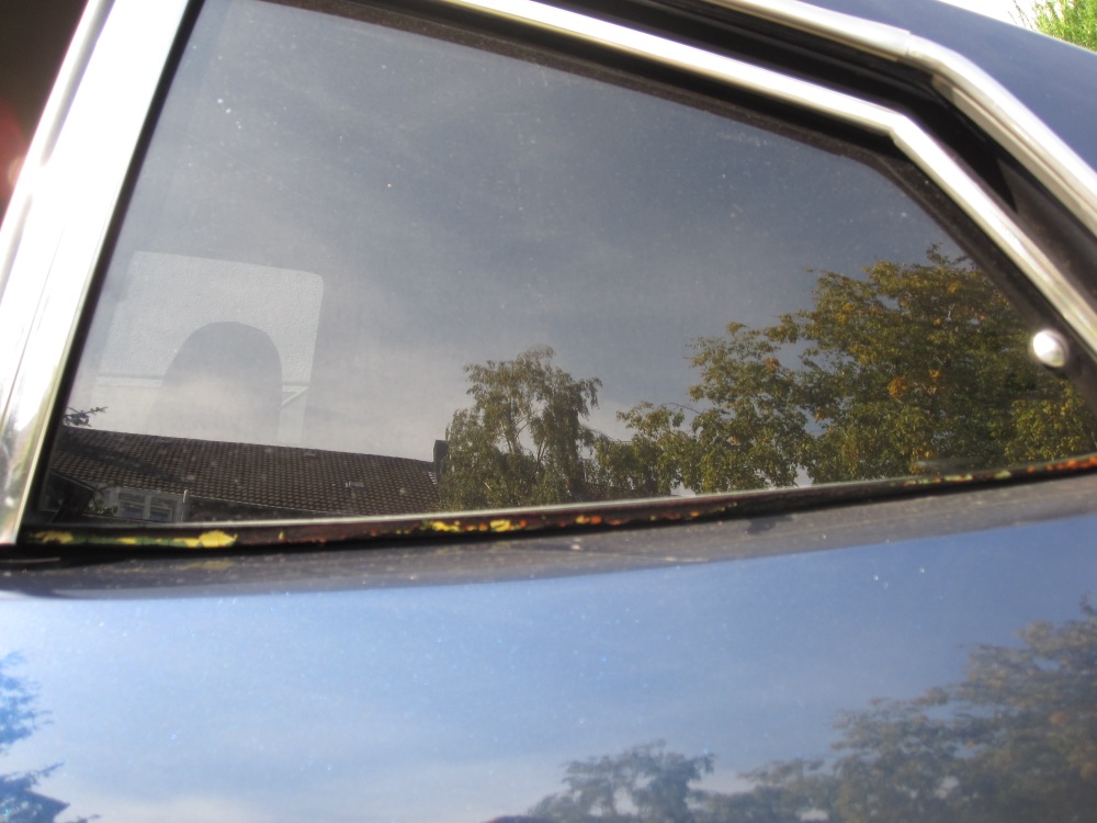

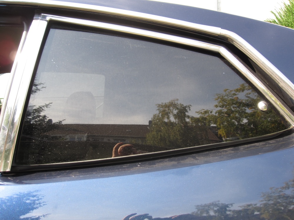

    i received the new quarter seals and installed them today. perfect fit, pictures to come.

    quarter seals went from this:
    to this!
  9. mercgt73
    Those seals look great! I'm glad they went in without a hitch. :thumbs2:

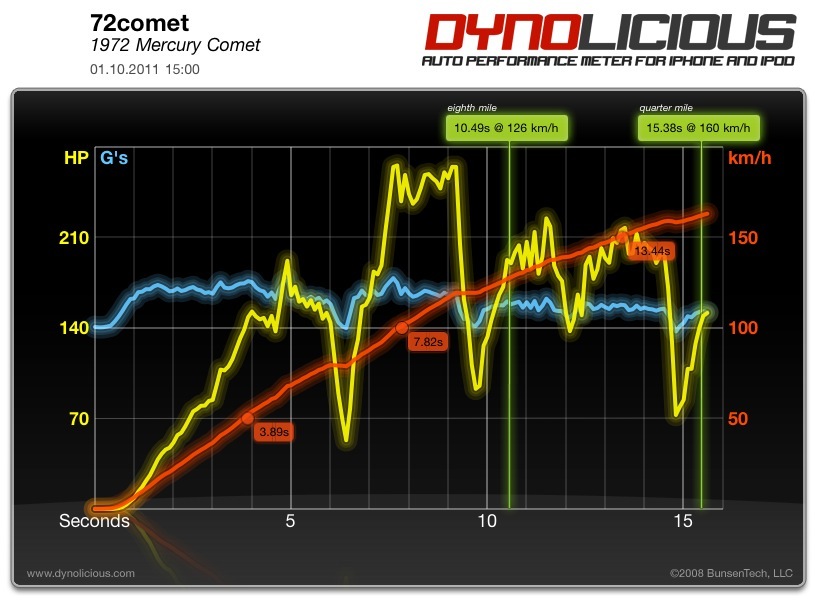

    played around with the dynolicious app today.
    put the comet on the scales - 1500kg / 3300lbs
    found a road which was just long enough - you still can see i was too afraid to push it any further in 3rd and 4th. thus 275 rwhp in 2nd. not too bad, i'd say - as the car is not tuned in yet, i run a 600 holley with stock jetting...
