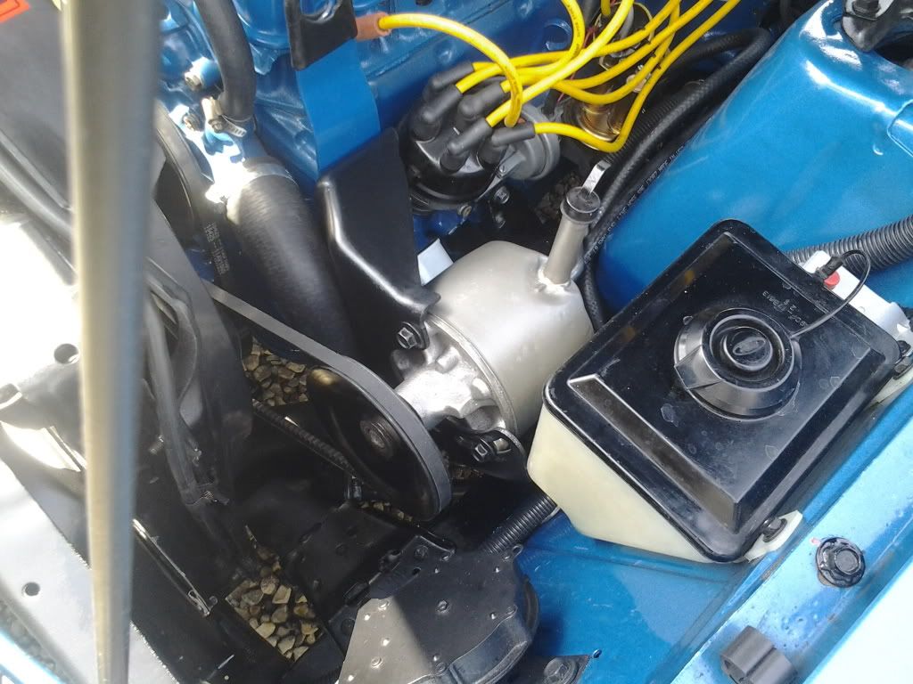

    Had a decent afternoon. Got the PS pump switched over, seems to be fine. Then spent the rest of the day detailing the exterior. The front clip was covered in over spray. Buffed out the entire car, opened the hood to clean the edges and DOH! The engine bay was covered in dust! I hosed it out and wiped it off. I dont think Ive ever used the same shammy on my engine and the body, was a good feeling. Cleaned up and ran out to buy a new head unit. Picked up a Pioneer HD radio head unit to install tomorrow. Then I can finish putting the interior and trunk back together. I feel like I have a better handle on things now. Slowly but surely.........
    Pic of new/old PS pump....sorry Paul, still the wrong color!
