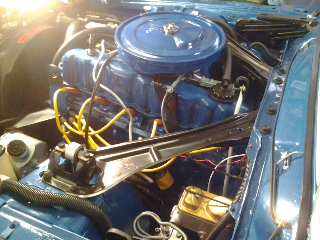

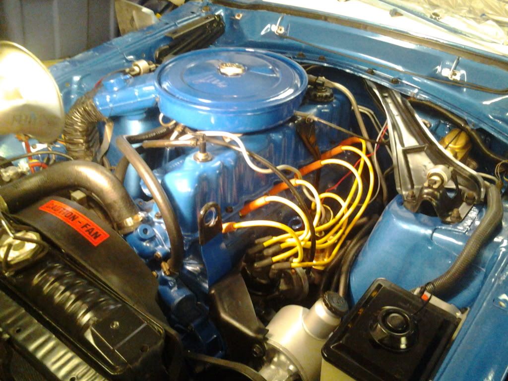

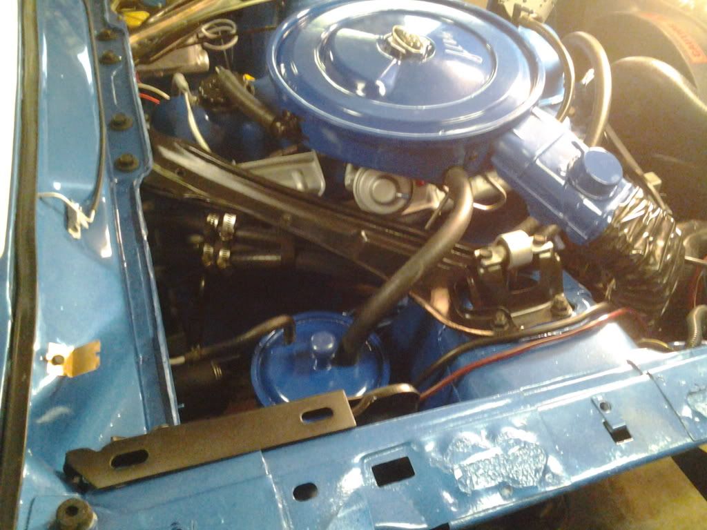

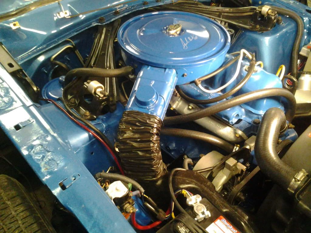

    Im as finished as I can be right now. Just need the lower rad hose and its ready to fire. Installing the new upper radiator hose I realized a new problem I have. My radiator isn't going to work. The hoses on the 250 are larger in diameter and won't fit my current radiator. I cut a small piece of the old hose to fill in on the upper hose. I'm not sure I have the room to do that on the lower. I'm also concerned that there won't be enough flow for the larger engine. I can't afford a new radiator for a couple weeks, so I will make this work for now.
    It was eating at me to turn the key, so I did a little pre-start up checking. I have my alt warning light like I used to, the cd changer loaded as soon as I connected the ground on the battery. I have brake lights, blinkers and parking lights, couldn't check the headlights because the fenders are off. I bumped the starter and that worked also. My radio doesn't work and neither does my right side interior neon. :hmmm: I checked the voltage at the coil because I rewired a lot of stuff including the ignition. I'm only getting about 6 volts at my coil. That doesn't seem right to me, I will go out later and nose around under the dash and make sure I got everything right. Oh, when I checked my coil voltage, I put my meter on the positive and negative sides of the coil. Is that right?
    Here are pics of the engine all put back together.
  4. doncomfort
    Apr 16, 2012
    1,289
    chillicothe oh
    Ta daaaa..... fixed the ignition, I have battery voltage at the coil now. Got my radio working as well. Cleaned the garage and the car. Gonna be a long 3 days waiting on that hose!
