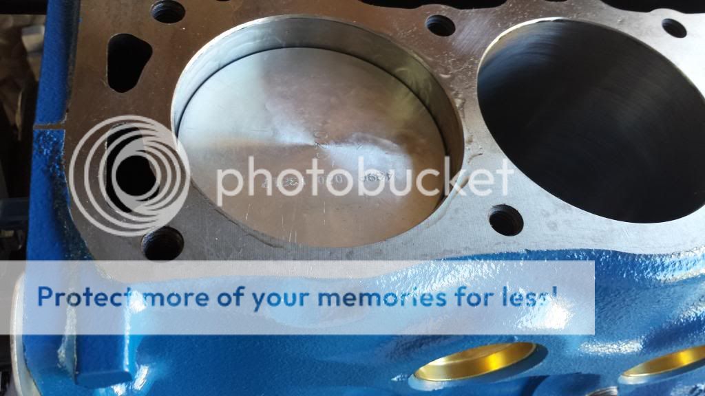

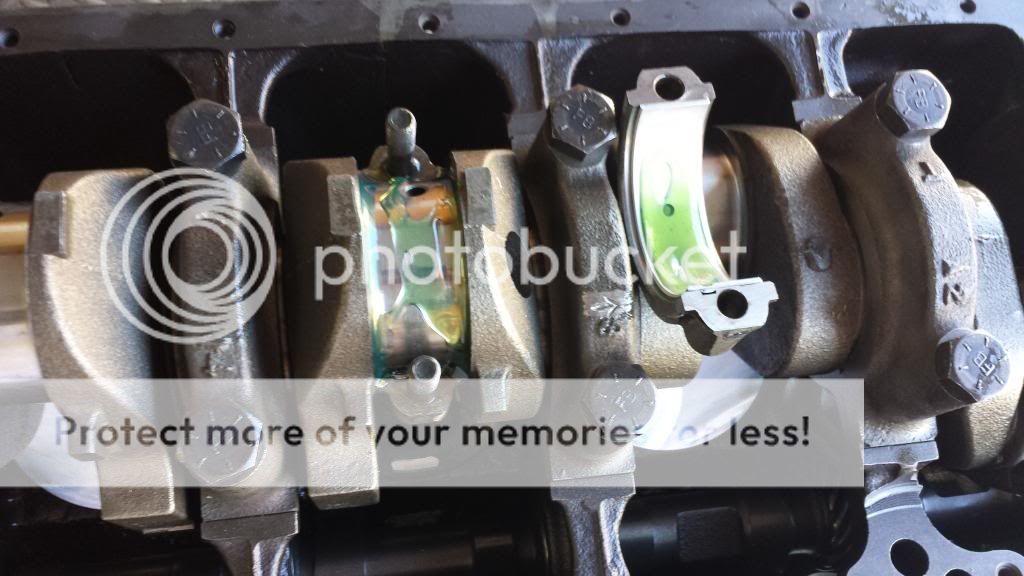

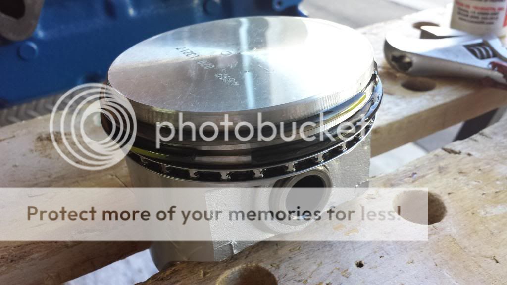

    Pistons!
    Was able to get 6, 3 and 4 in this morning, should be able to complete the rest over ye weekend.

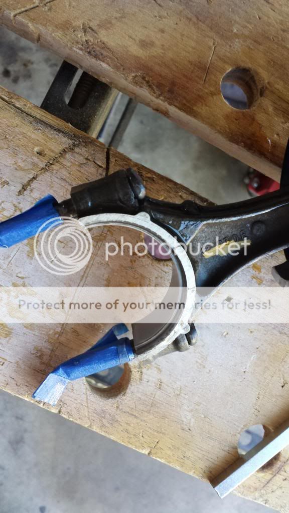

    Found that using the little black and decker table worked great, just opened the jaws wide enough to rest the piston skirts in (for reference, do not clamp). Made putting the rings on easy peasy.

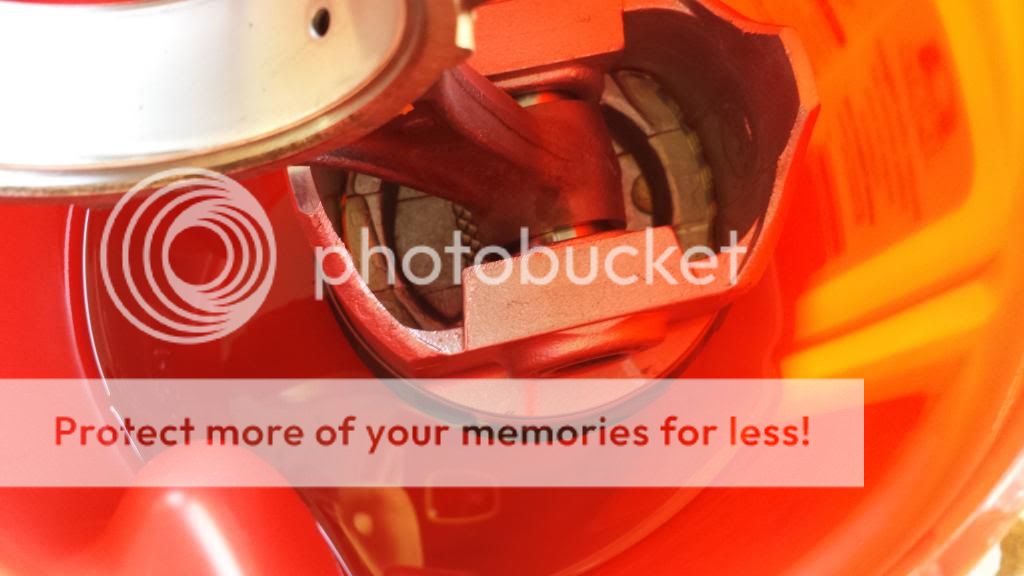

    Oil Bath!
    Shot of number six.
    Used a little blue tape as protection.
    Plenty of lube, btw, this shot made me nervous.... YIKES! (don't drop, don't drop, don't drop!!)
    And three and four.

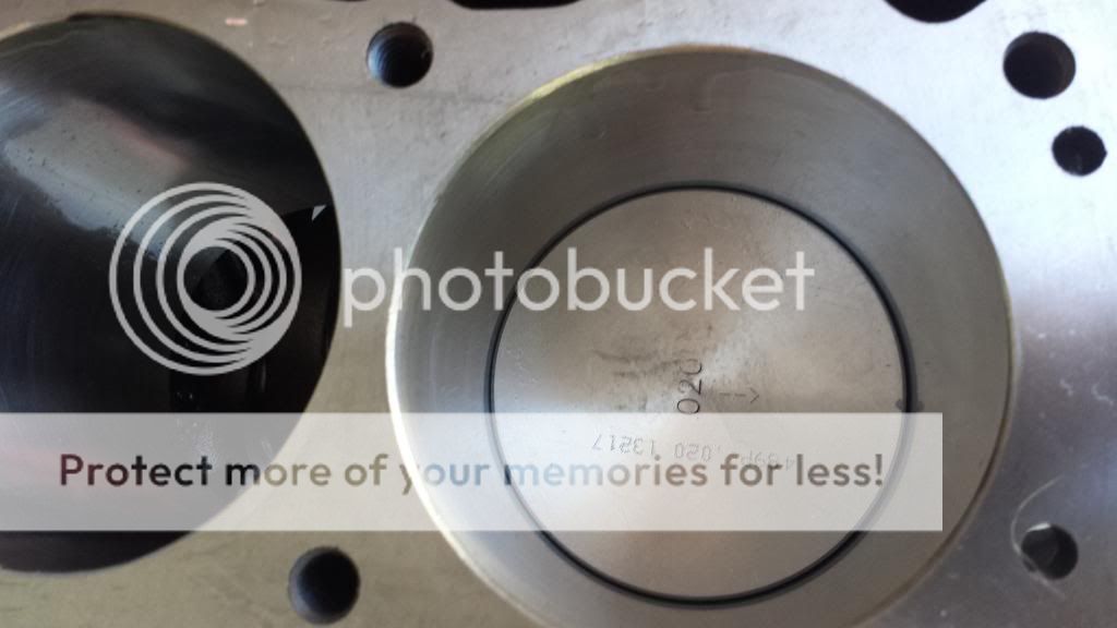

    Not sure if you can see it but there are very small arrows that look like this ---> on each piston.
    I installed all of them pointing toward the front of the engine but if I'm wrong, I sure would like to catch it now before I take the next step. Let me know!
  12. 71gold
    I was just JK, they are in correctly... :thumbs2:
  13. rthomas771
    8,090
    979
    Just stand on the other side of the engine before you take a pic and then it won't be upside down. (y)

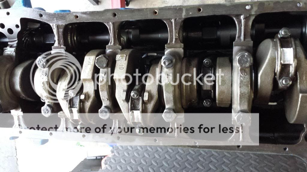

    Couple quick pic's, all pistons installed!
