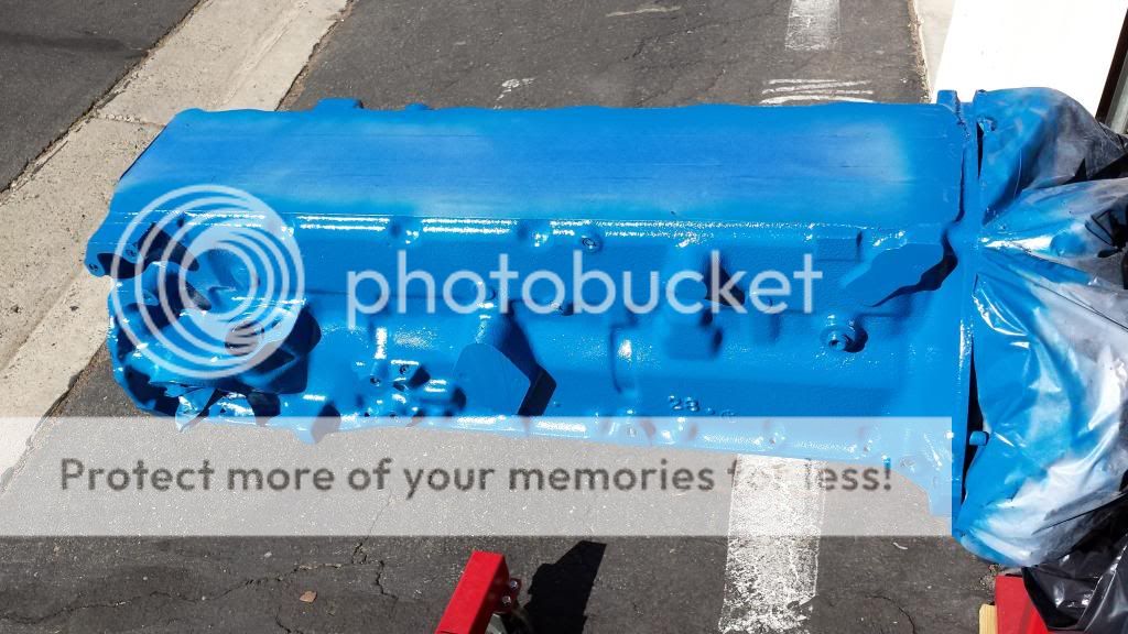

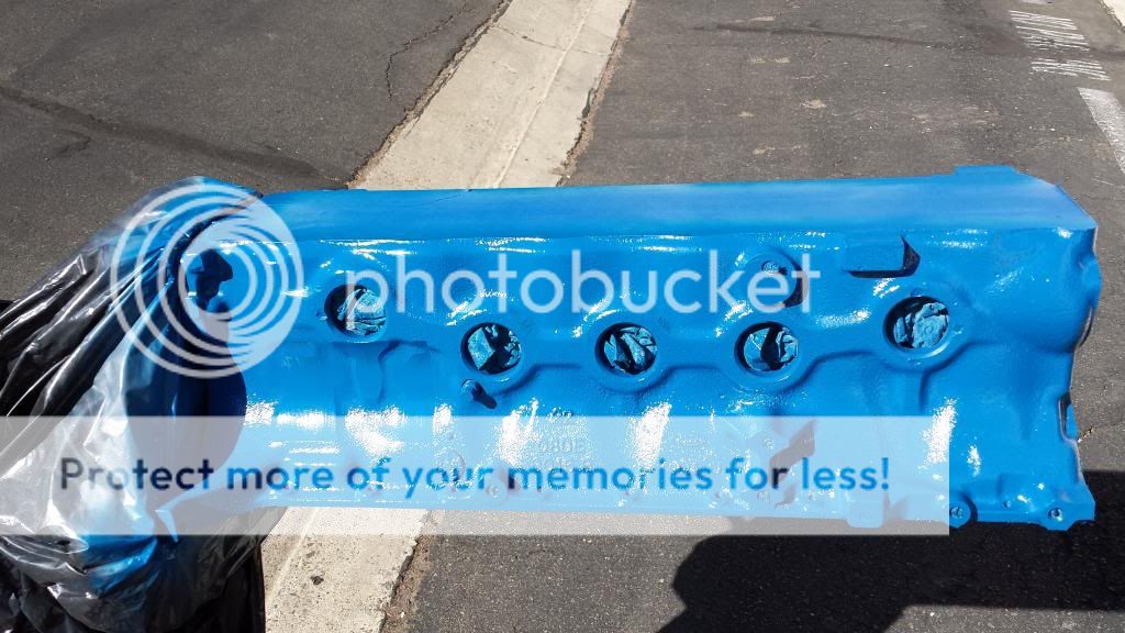

    That's just the shadow, it's was all grey primer.
  2. Dave B
    I thought it was some sorta baby blue... :)

  4. 71gold
    never seen "engine primer" used...:huh:

  6. kboldin
    Jun 10, 2012
    701
    93
    Santee, CA.
    I don't think its required either, the block was nearly bare when I got it and there was a lot of surface rust on it. It was really visible after the hot tank process. That's why I hit it with some rust converter and used primer. Just adding a little extra protection.

  9. Dave B
    I've never used primer on an engine block.
  10. 71gold
    never used it on any engine I've painted...didn't even know they made it.

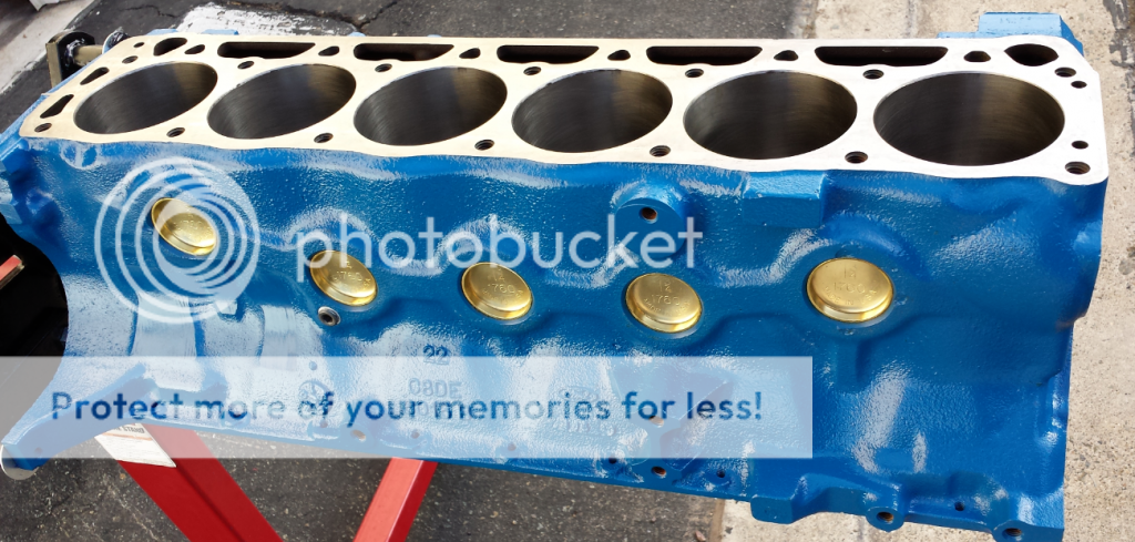

    Made some more progress today, installed the freeze plugs, front galley plug and the drain plug. I used aviation permatex instead of JB Weld on the freeze plugs. After using both I really think it comes down to preference. See pic's below!
  12. 71gold
    I like the way you clocked the writing on the plugs...:thumbs2:

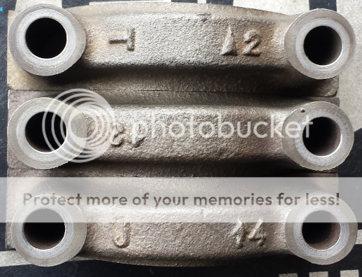

    Weird… So I’m finally making some progress and noticed a slight oddity. The number three main cap appears to be mismarked? Looking at the arrows, they should all point forward, I noticed the number three arrow is pointing backward so I swapped it around so it would point forward. I went ahead and plastigage the bearings and got an odd clearance on that main cap (see results below).
    Comparing a picture at the time of tear down, sure enough the number three main bearing is pointing backward with the digits lining up with all other main cap digits. I think this is likely the cause of the odd clearance measurement but I didn’t have time to verify it before I left for work. Regardless I think it should go back in exactly the way it came out but I will check the clearance again after it’s positioned the right way and see if I have a different reading.
    If you have any insights I would appreciate them, I think it’s extremely odd that it’s stamped backward.
