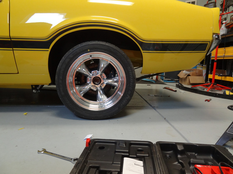

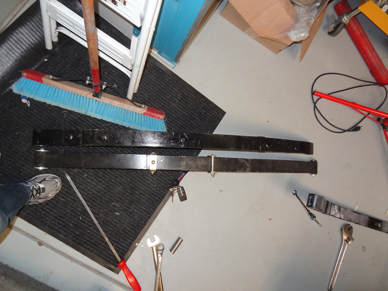

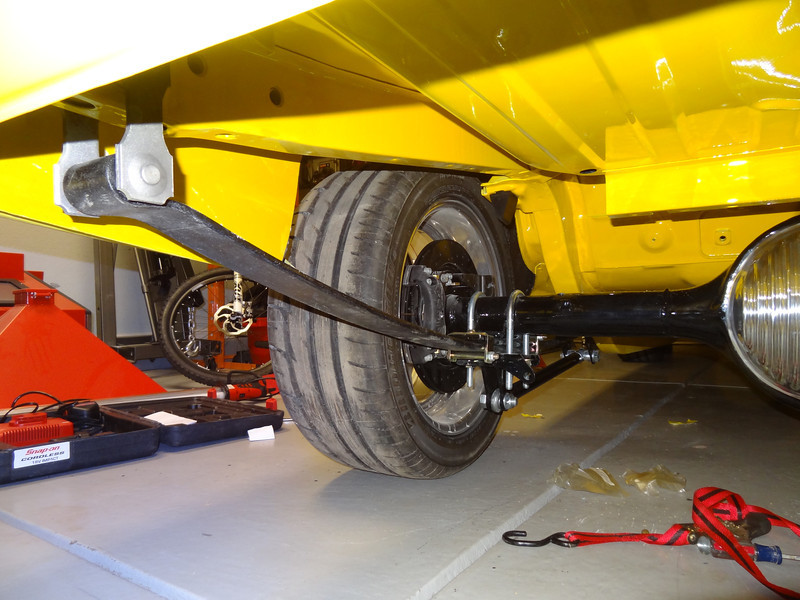

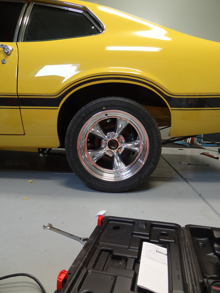

    I haven't had much time lately to work on the maverick due to being out of town for business almost every week. I finally took some time off and got a little done.

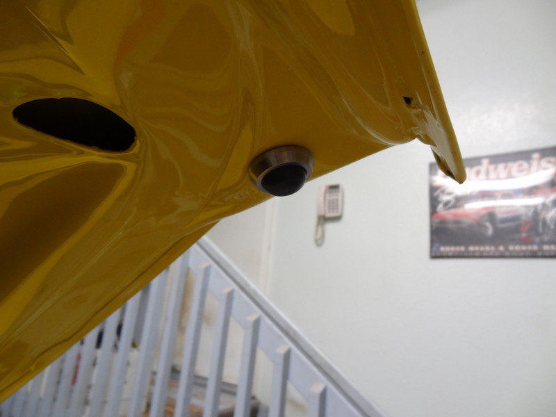

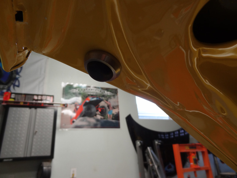

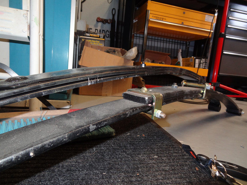

    I got the leaf springs swapped out and installed the rear axle bumpers. I got to work on a little bling on the 9 inch rear axle. I also installed new trunk bumpers. I was going to install the gas tank but I am thinking that see the results in the new springs and the feedback that I have read about calvert racings springs and the fact they do not tend to sag that I am working with Calvert Racing and getting a set that has a 1" drop built into them.
    The swap from the esco springs to the Calvert Racing Springs dropped the back at the wheel well 3 1/2". Looks better but I wanted a slightly lower stance hence the exchange for the ones with a 1" drop built into them.

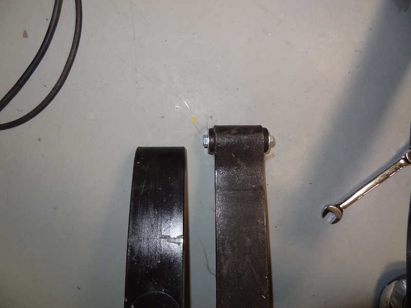

    Notice the difference in length:
  13. blugene
    10,776
    Don't take it the wrong way but your rear end is nice :thumbs2:

    I have been working with Calvert Racing on these springs. This is the first set sold that were made with street driving in mind. The springs are not listed in there catalog. I knew the first set of springs from the other company were going to be to tall for the car and I knew that when they were installed the first time that they would need to be replaced. That is when I called Calvert Racing and spoke with a representative over other ideas when he offered the new springs. They have amazing customer service and is willing to work with you on your set up.
    It is worth the extra 40 minutes to swap out the leaf springs to hopefully create another option for maverick and comet owners.
