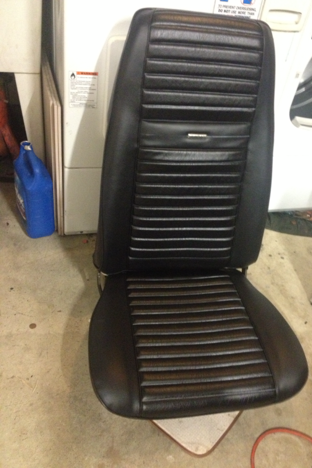

    I got re-motivated after looking at a few builds going on so I got back to the comet. I redid the seats on the comet after buying a seat cover set from a popular member here on the site. Not a great photo but its what I have. The foam was redone as well, I still need to redo the driver seat but the rears are done.

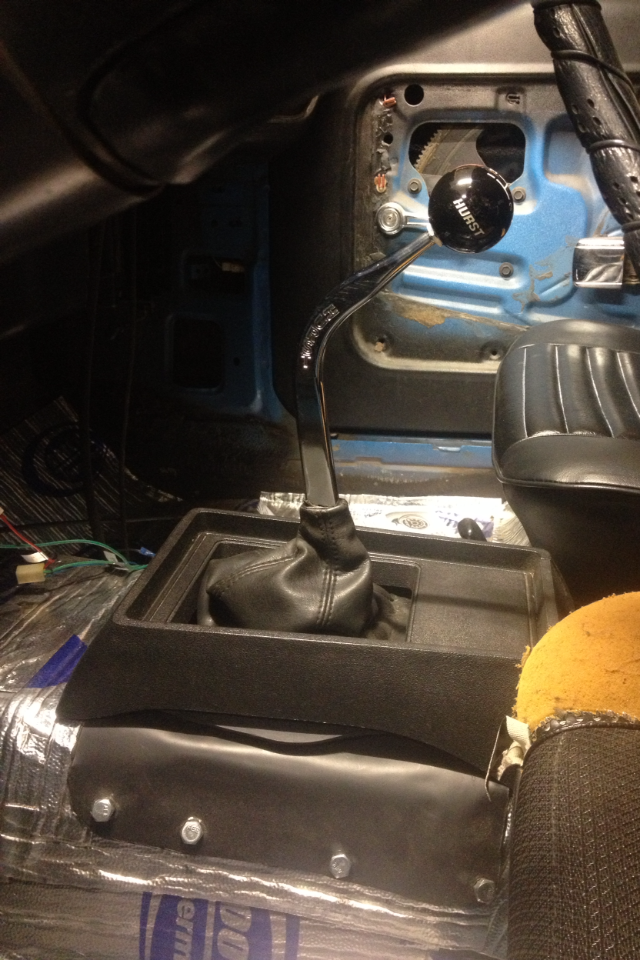

    I've been searching for a console for the comet. I like the Mav/Comet consolette but they're scarce. So I picked up a mini console off eBay from a 70's mustang. It still needs to be trimmed but ill do that when the carpet goes in and that will be after paint. The shifter is a gold base Hurst short throw.

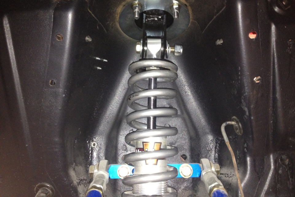

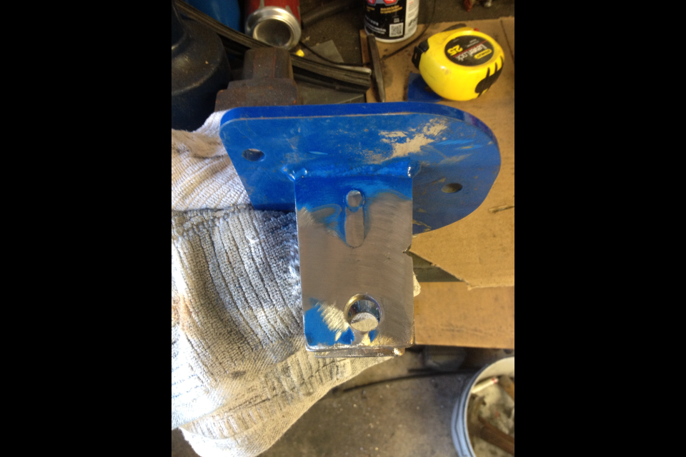

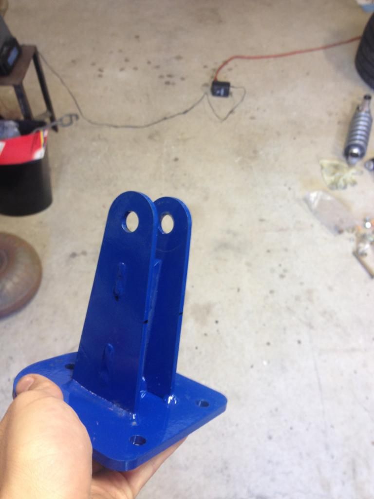

    The ride height was too high with the tcp coil-over kit. After some notching and cutting on the upper bracket I got the desired height I was looking for
    Before
    After cutting and welding.
    Installed, painted black and final ride height.

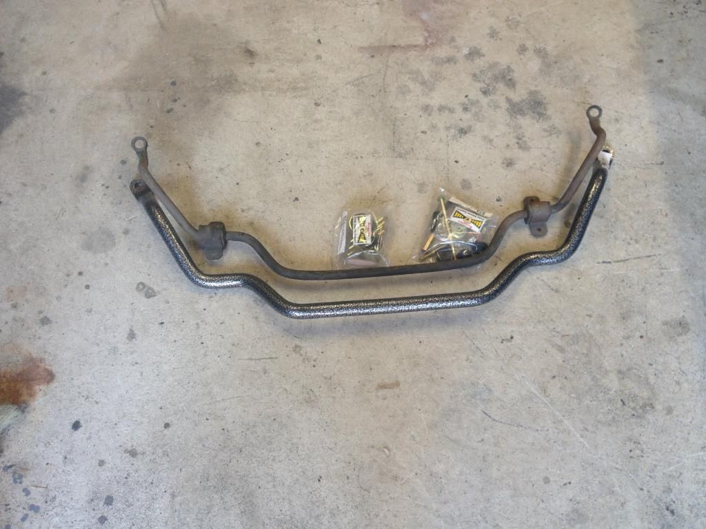

    I picked up a 1 1/8 sway bar for the front. It's for a 65-66 mustang. Here is the stocker and the new one. Pretty close in dimensions, with the 65-66 bring a little wider. I only had to elongate the mounting holes to the body. It's still a little off but I'll change that later if I have to.

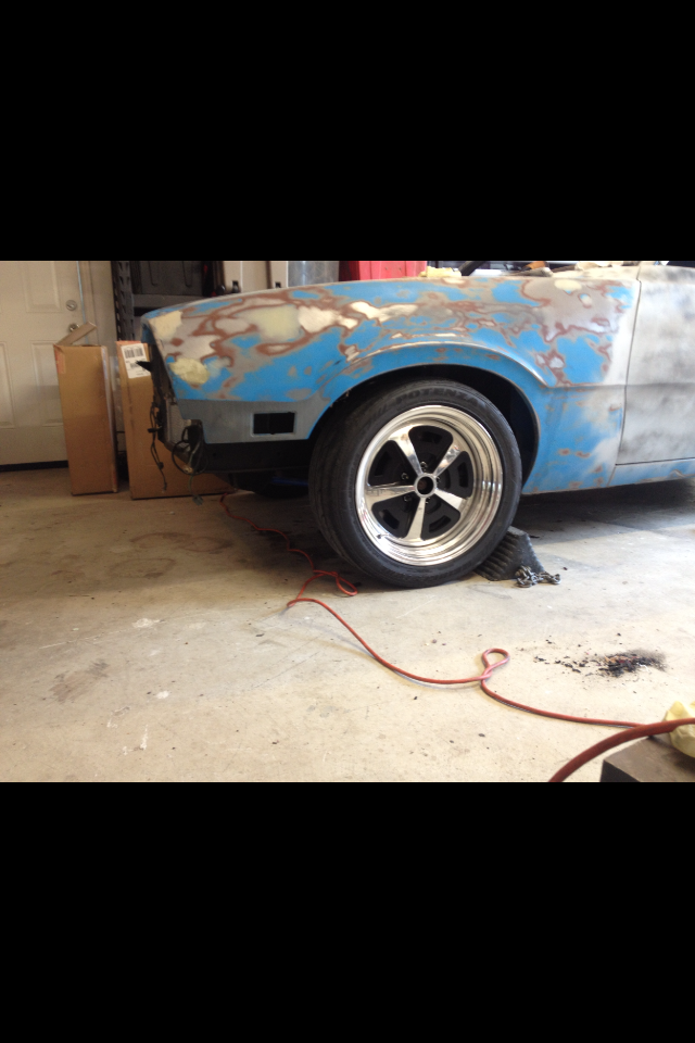

    Started removing the paint. I'm using a ain't remiving wheel
    Let the wheel do the work, don't add too much pressure or stay in the same spot for too long. You can warp the panel you're working on.

    I also tried the dupli color aerosol can style paint removal. It worked pretty good maybe even better than the aircraft paint removal stuff in the can. I'm trying a combination of both. It's working better on the factory paint than the fender that was repainted.

    Getting closer, pain in the arse but will turnout a better product in the end. I'm contemplating in doing the paint and body on my own but what takes me an hour a competent body man will do it in 15 min.
