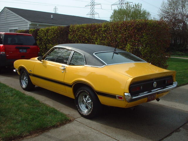

    I indeed have XM installed. I have a separate XM receiver that connects to my Sony head unit, so there was nothing extra to mount to the dash.
    The cassette adapter is one way to get audio from the XM receiver to the stereo in your car. Although it offers a slightly better sound quality, I wouldn't bother with all the extra wires. The Delphi Roady 2 has a built in FM modulator that works very well. This way, all you have to do is set one of your presets on your existing car stereo to 88.1 (or whatever you set the modulator to) and you can listen to the XM!
    You don't absolutely need a cigarette ligher. You could hard wire the power adapter to the wiring harness in your car to get power to the XM receiver.
    You will want to mount the antenna on the roof for best reception. I used one of the old thru-the-glass antennas..I liked the way it looked. The tiny square magnetic mount ones they have now actually work better and are real easy to install..they have about 25 feet of really thin wire attached so you can route it just about anywhere ya need.
    I absolutely love XM, btw. Lots of entertainment bang for the buck! :) Here is a shot of the antenna:
