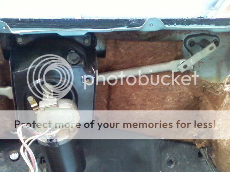

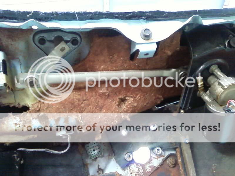

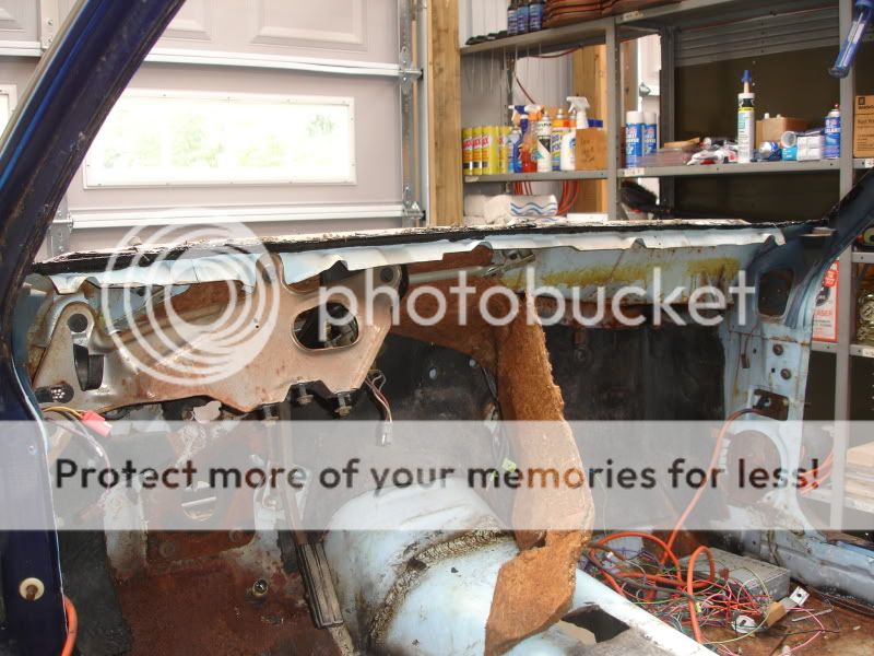

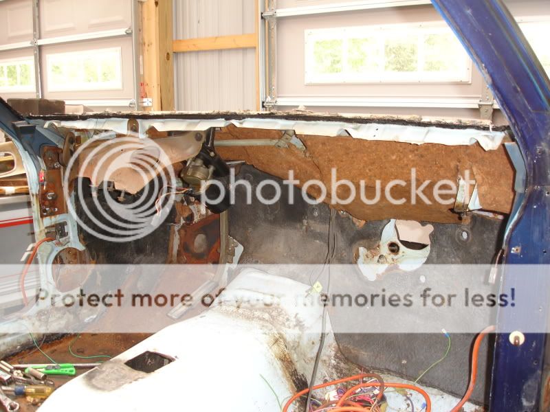

  13. mercgt73
    Here are some pictures if it helps:

    Thanks as they say a picture can say a 1000 words it definitely helps
