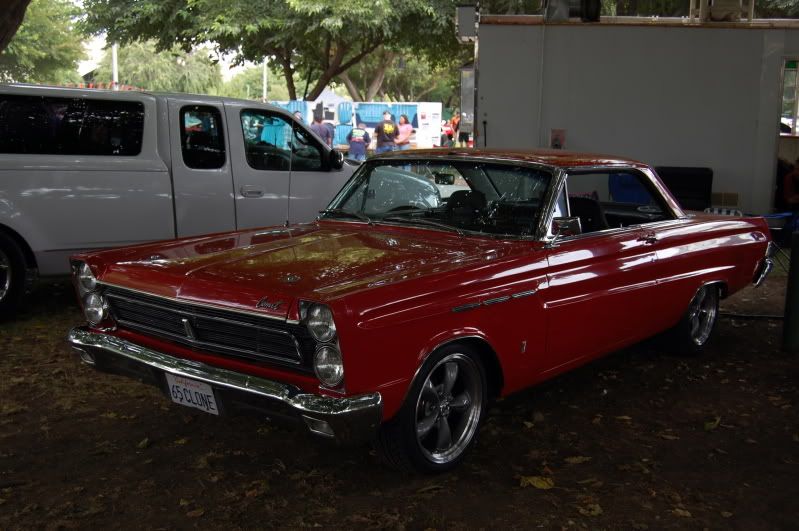

    Bolt on wheel spacers are your friend. 1-1½" should do the trick.
    Unfortunately, this is neither my photo nor my car.

    Wow that comet looks good! I got to get me some spacers coming.

    wow, nice car . . .
