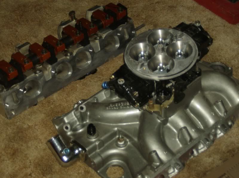

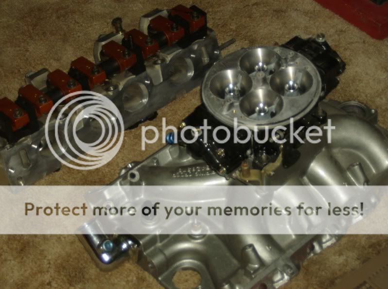

  10. Mtrain
    Mtrain Member
    Dec 5, 2011
    27
    65 Mustang black/gold Shelby theme, 67 Eleanor blown 427FE tunnelport
    TP heads, and intake....
