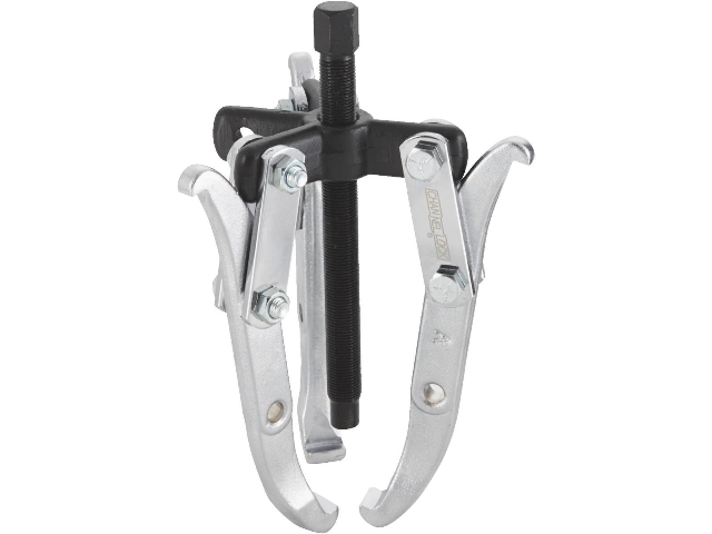

    I also have pulley and gear pullers, 3 and 4 armed doohickies with a large screw in the middle.
    Kinda like this.

  10. Dave B
    There is a specialized tool for removal and installation.
  11. scooper77515
    So, you are saying that this...
    ...is not a specialized tool?
    Yes, my wife has three of them in the kitchen, as well, but still, kinda "specialized"
  12. scooper77515
    She uses them to pull the pits out of avocados.
  13. Dave B
    Yeah, that's not the tool.
  14. scooper77515
    I figured there is one that takes advantage of the three little holes in the face of the pulley.
