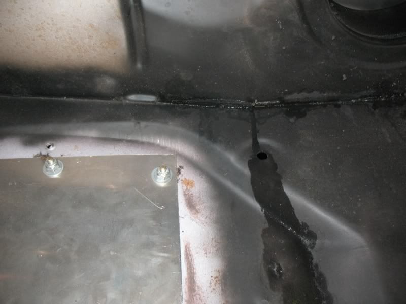

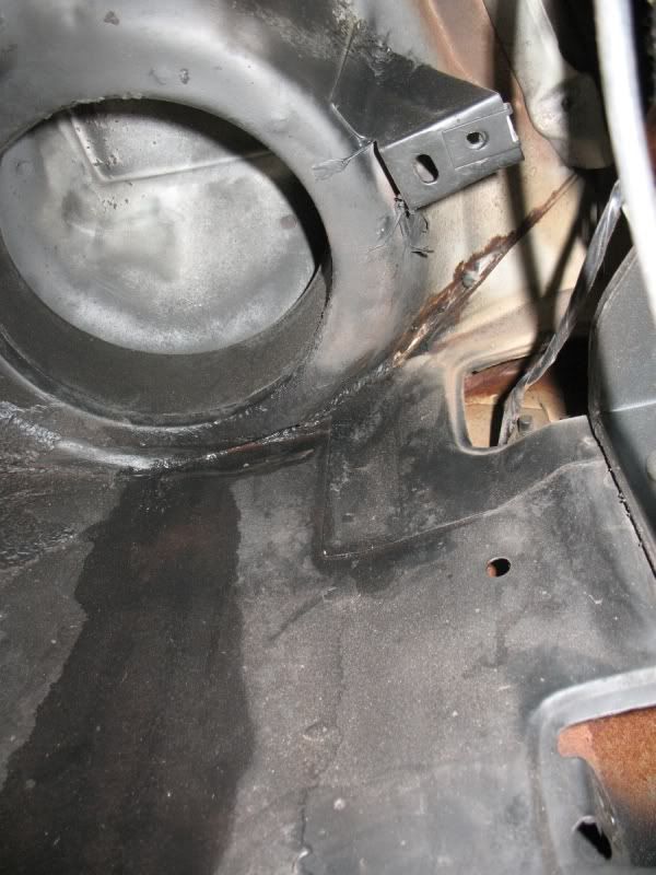

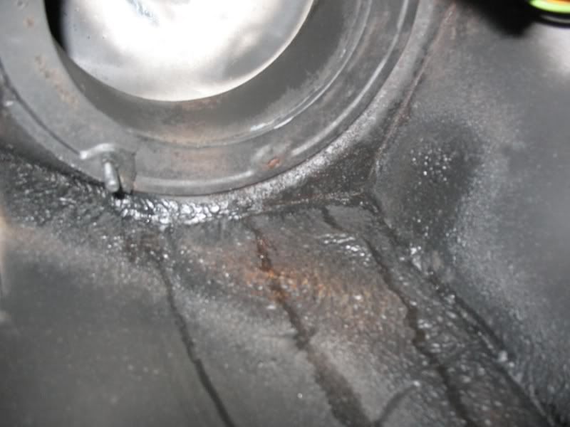

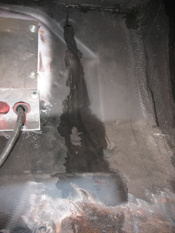

    ripping apart the cowl panel is out of the question because i had the car painted already..the vents are solid, but all of the seams are leaking(pics)
    if i seal the seams from the inside i feel like thats not really resolving the issue..help please

    Seam sealer might work, you'd have to get to it from the top, reach up and around...

    I'm not the expert here, just did one. But, I'll offer some comments anyway.
    The leaking seam in the picture is the cowl seam under the hood, right? Did you or your painter remove the cauking from the cowl seam under the hood? Or, is it cracked? If that's the leaking seam, I'd remove all the old caulk on that seam and renew it from the outside (under the hood). There are three layers of sheet metal there: the cowl cover, the cowl floor, and the firewall. The seam that needs to be sealed is the onoe between the cowl floor and the (bent over) fire wall.
    For the seam around the "hat", I would caulk it from the inside -- under the dash. Don't know any way to do it from the outside without removing the cowl cover.

    You stick you hand up through the hole, put some sealer on your finger, wear a glove.

    yeah i can reach in there just fine. i will have to try that.. the leaks have gotten so bad; where the top door hinge bolts to the car is full of rust and rust flakes, its real bad. i will get a pic of it.. thanks guys

    I would think that with any of the rust inhibitor products such as rustoleum or por-15 you would have to do some surface prep and also apply it on the metal directly. pouring it on may work for a short time but I think water will work it's way through. It seems that your best bet will be to attach the problem from the bottom where you took the pictures, you have good access, I don't see why you can't fix it from there.
