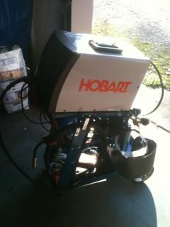

    On a side note for you guys that have MIGs or plan on getting one in the future, I took a shot with one of those MIG carts from Harbor Freight recently. I was surprised at the quality. It's very sturdy. I had my doubts after getting one of their tool carts....it was very thin and flimsy.
    I got it on sale plus 20% off with a coupon....around $40 I think. My Hobart fits great, I just had to space it up a little so the side door would open.
