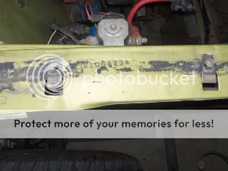

    I'm going to look at a 1972 Sedan and I'm not sure of VIN locations other than the dash. Where else should I be looking? Thanks, JimM
  2. Dave B
    First is the dash, second is the "B" Pillar sticker, then third and forth are the inner fenders (both sides, just before the shock towers), but you'll have to remove the fenders to find the numbers, and that's only if the lips that hold the fenders on, are not too rotten.
