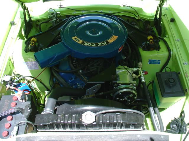

    Here is how I ran my lines. Stock lines are little different but the compressor lines are in different spots so it ran best like this.

    Thanks for the pictures ! Please post more...
    Thanks for all the pictures. I like pictures :)>
    Please post some more.
    I'm especially interested in the receiver/dryer location and lines to/from it.
    The condensor has a big fitting and a smaller fitting. Which one goes on top. They both point out of the same side, I don't want to mount it upside down.
    Thanks again.
    Also. Right now the engine is out of the car. I'm just trying to get a feel for what will go where when I install engine and A/C lines. I have a Sanden compressor like in the pictures. Can someone give me a quick in car measurement of the compressor location? Just measure from compressor line to rad support and from compressor line to fender apron. I want to mock this up before hand.
