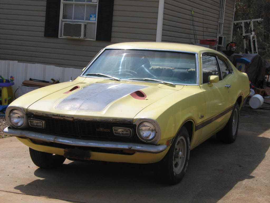

well we brought it home yesterday spent most of the day cleaning it up might do some more cleaning today and rebuilding the carb eric is really excited about his toy i took acouple pics of it will post them later today hopefully it dont start raining does anyone know of a good aluminum mag rim cleaner/polish? later Terry
