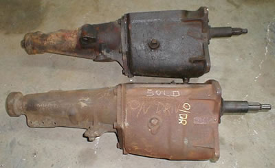

    OK I just found something that told me pretty conclusively that is is a
    3 speed OD tranny
    My tranny DOES have this buldge in the case on the passenger side....
    http://www.davidkeetoploaders.com/imposters.htm
    http://www.davidkeetoploaders.com/images/TL-OD5.jpg
    So I guess it is NOT a "TRUE" toploader. I gues it is an Imposter... LOL... I personally like the gearing in it because it is quick 1st - 3rd and fourth is giving me some pretty good gas mileage. But now I am not sure if it is going to hold up after reading what I have read about the 3 + 1 Trannies being weaker than a real 4 speed toploader... I also don't know what I would do about a shifter for the damn thing now either. I am going to guess that a regular 4 speed top loader shifter and install kit won't work on the Overdrive tranny... does anyone know about that???

  12. spork1o1
    spork1o1 Member
    Jun 6, 2006
    626
    Michigan
    sounds like a SROD
  13. bradleygt
    bradleygt Member
    Aug 24, 2008
    485
    grand rapids michigan
    1970 maverick
    x2 they used them in mustangs and fairmonts has the same bolt pattern as a toploader but still weak
    brad:)
  14. spork1o1
    spork1o1 Member
    Jun 6, 2006
    626
    Michigan
    does it look like this
  15. spork1o1
    spork1o1 Member
    Jun 6, 2006
    626
    Michigan
    this is a mustang II srod 4 speed
