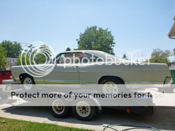

    You've got a lot of tire for the motor..........................11.5" wide?:huh:

    they were on a 67 Galaxie i picked up last year. I put them on the Mav. while the Galaxie gets a frame swap.

    how hard is it to stuff a 390FE in to a maverick?:burnout:

    My question would be why?
    The old rule of thumb is that for every 100lbs you take out of a car in the 1/4 mile you will loose 0.10 sec at the traps and conversely the more weight you add the slower you will go. This all depends on HP/TQ of course.........................but just being general you want to lose weight.
    Your 302 is 29" Long 24" Wide and 28" High w/o carb weight is 460lbs
    351w is 29" Long 25" Wide and 29" High w/o carb weight is 525lbs
    390 is 32" Long 27" Wide and 29" High w/o carb weight is 625lbs
    If you go with about any other motor than the 302 in your Maverick you will end up cutting the spring towers out/notching them or doing away with them entirely.
    Plus you can make more HP with a 302(331/347), 351w than you ever can with a 390..........and spend less money...................IMHO

    The 390 is going back in the Galaxie
    I will more than likely just freshen up the 289 that is already in the Maverick this winter.
