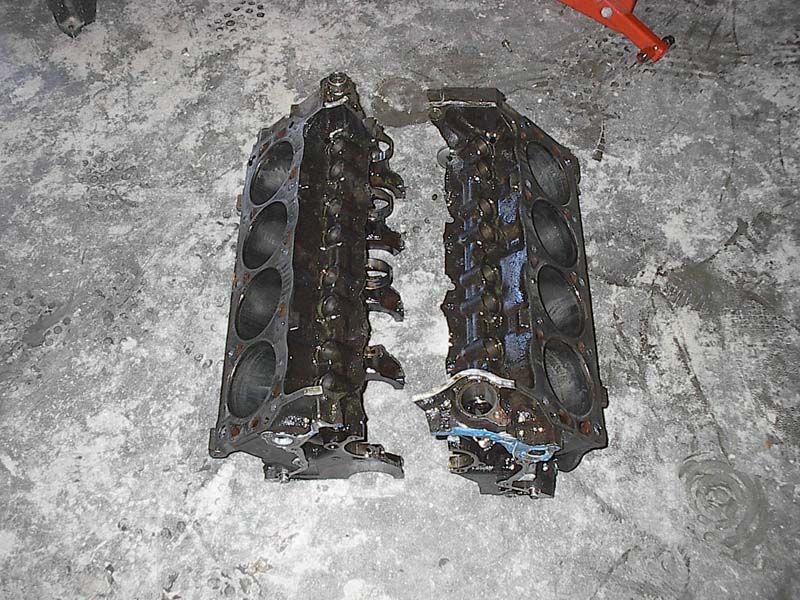

    Are the HO blocks stronger than the older 302s?
    I keep hearing that the blocks start to split around 500 hp. Wondering if that is true, and if so, is it the same for the 5.0.
    Specifically, how does my '85 model block stand?
  8. Krazy Comet
    7,734
    2,441
    Internet hearsay...:rolleyes:
    I believe it's the '85 that is the lightest(thus weakest) of all 302/5.0 blocks but not even the early ones are a mountain of strength... It's the combination of power & RPM that causes them to split...
  9. scooper77515
    Any idea what that guy was running through that block when it split?

  14. scooper77515
    With a hit of nitrous, or some sort of compressor?
