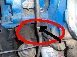

    well my mav had been stalling at mid-WOT so i adjusted the acl pump and today i was working on the power steering and guess what i found somehow i had flattened out my fuel line.....i just bought a tube cutter at harbor freight(my new favorite store) so nows a good time to use it...i also bought a pressure/vacuum gauge but it was already messed up have to return it tomorrow...i hope after i fix this it runs great like it was last month.

    well that can't be too good for fuel flow. :D

    That'll do it every time.

    Kinda KINKY!!!:16suspect

    Nahhh... I have seen smashed and worse. It doesn't LOOK good. Unless it is like really bent, then it may not be the prob. :sorry:

    well it was only half the problem when i replaced the line it would run well at WOT but died at mid throttle after tuning it about 100 times i got it to run great at WOT but i still have some problems:
