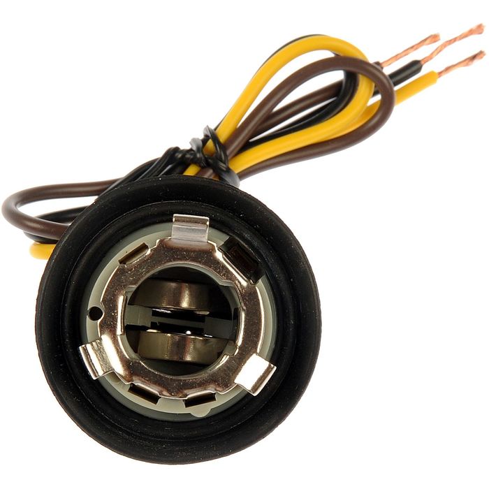

    I know this is a Zombie thread.... but I need the 1157 bulb holder for my 72 comet brake/turn signal lights. I've been to all the autopart stores, and they show a two wire snap in socket and I need a THREE WIRE TWIST in....they just don't give a f**k.
    How can this be so rare..... any leads??? Thanks.

    Autozone
    DORMAN Part # 85822 $5.99

    That did the trick....thanks
    funny thing is I looked at that one yesterday AT Autozone, but when I put in my old bulb the bulb was really loose and wanted to fall out. the contact bumps were to worn, making the bulb to short to stay in the socket.
    So.....hearing your recomendation, I went back (going there anyway for a new starter for my '75 E-250 Van and tried the socket again with a brand new bulb; it's fits well.... :)
