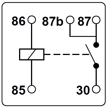

    That button could be made to work BUT, will require some wiring changes.
    1) disconnect(cut) power wire to horn contact at base of steering column.
    2)install relay, connecting trigger coil(terminals 85 & 86) to the now two ends of wire(s) just cut in step 1
    3)at steering wheel, connect horn button to wire(contact) that relay was just connected, clip off/disconnect ground wire
    4)connect power to switching contact of relay, can be from same source that was cut in step 1(contact 30)
    5)connect the wire that normally powers horn(second contact in column) to output of relay.(Contact 87)
    6) if relay has terminal 87B, ignore it.
    With these changes the horn button will trigger relay, which in turn powers horn.
