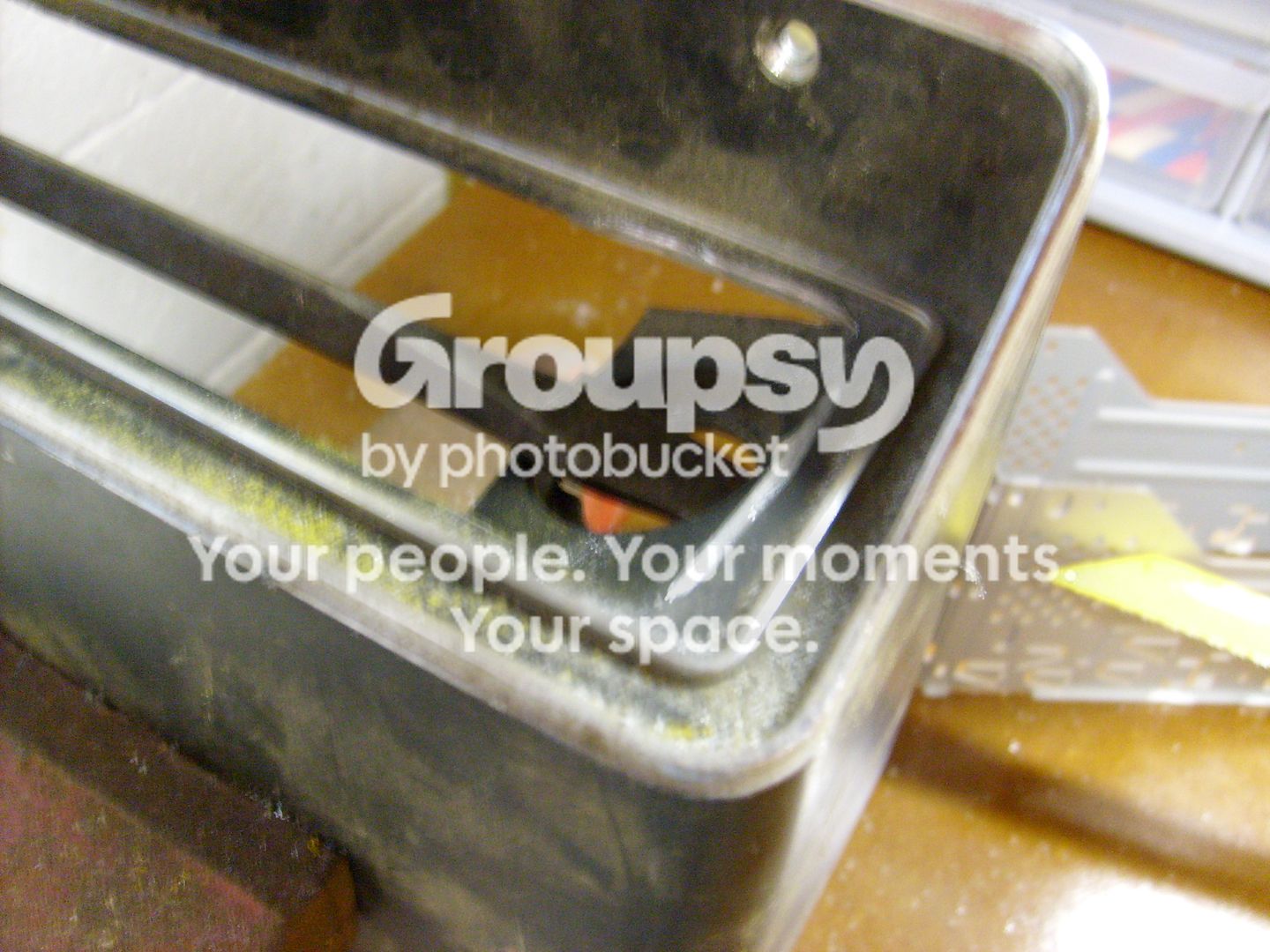

    This is nothing new to most of you, but I figured that I'd snap a few pics while I'm in the process of installing a new CD player in my 70 Maverick so others could see the process if they ever need to do it..

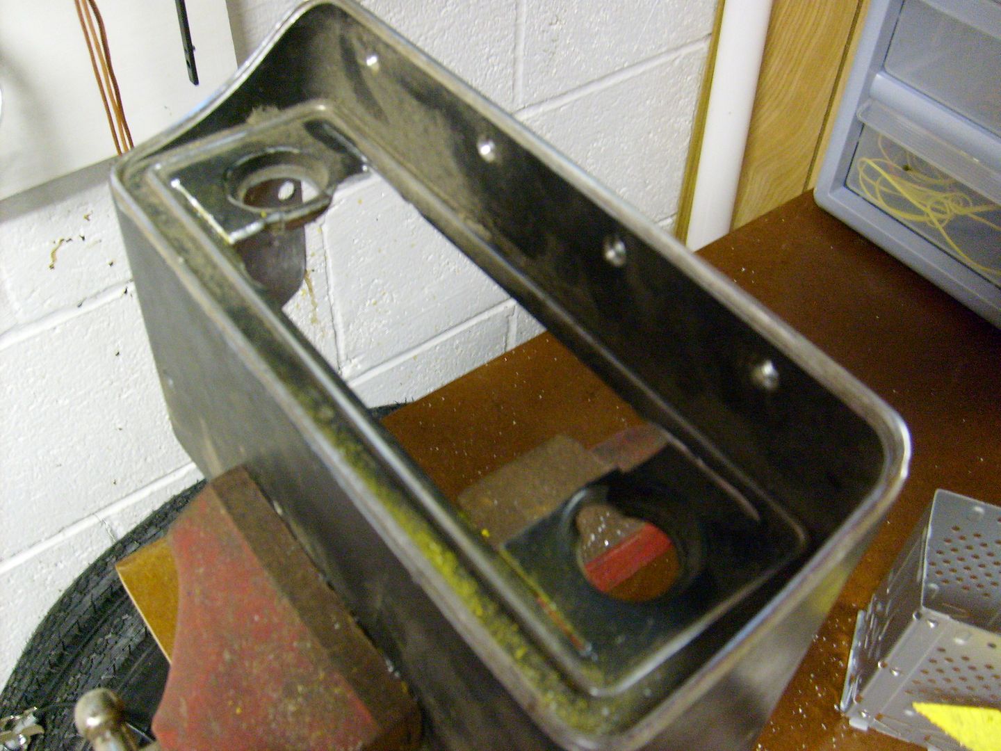

    I really dreaded cutting out the radio mount for the sleeve, but with the proper tools it only took about 15 minutes to get it opened up....but it will need some more work to get the sleeve to fit. I'll post the progress as I go.
    So here's the objective....to the this radio to fit into the original radio mount.

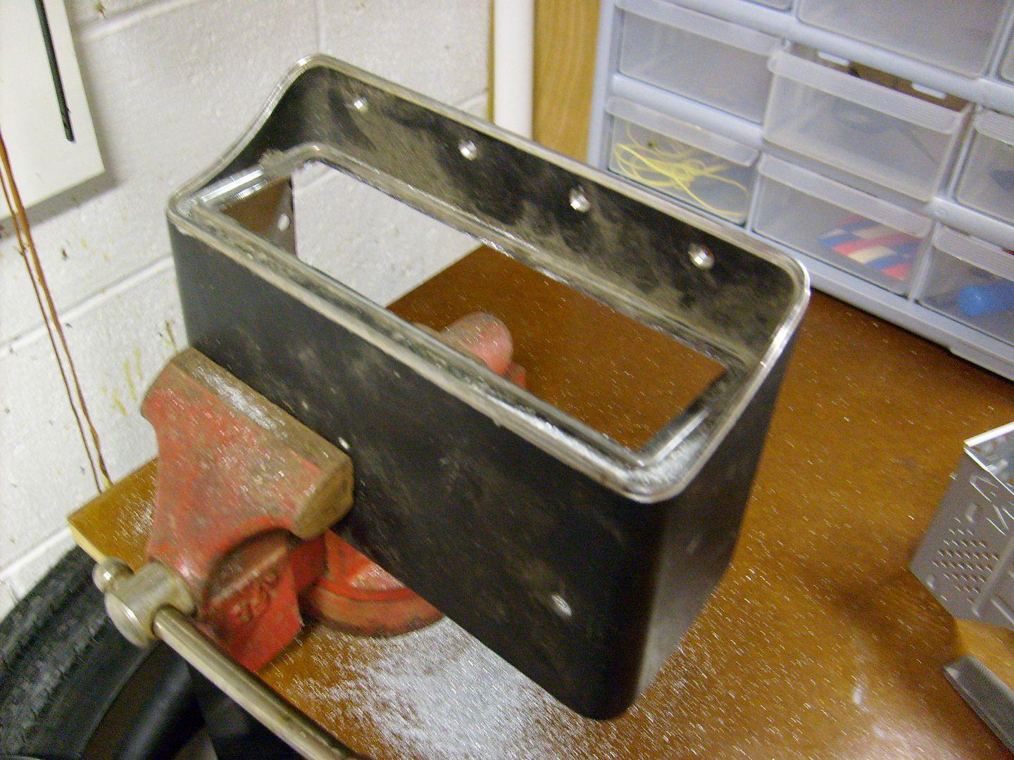

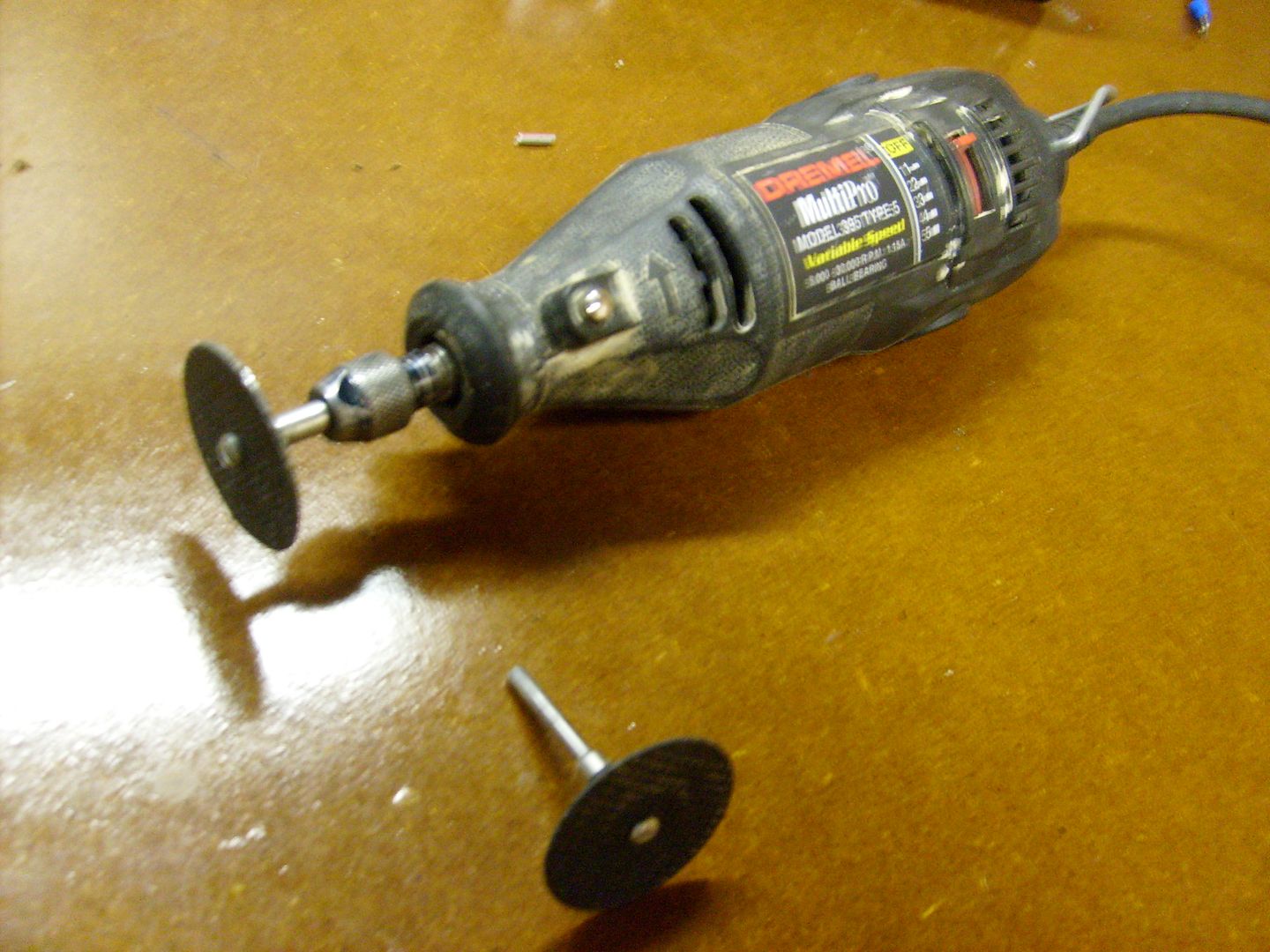

    At this point, this is my weapon of choice to get the cutting done...a Dremel with a fiber cut off disc.
    First I made the cuts across the top. Only cut out to the outer edge of the round part of the mount....where the original nuts held the radio in.
    Then I found that I couldn't get my Dremel in the bezel to make the cuts across the bottom so I put the mount in the vise and broke out the sawzall. I set it on a lower speed and gently made the cuts. It sliced through very easily...I guess I should have used it for all 4 cuts across the top and bottom.

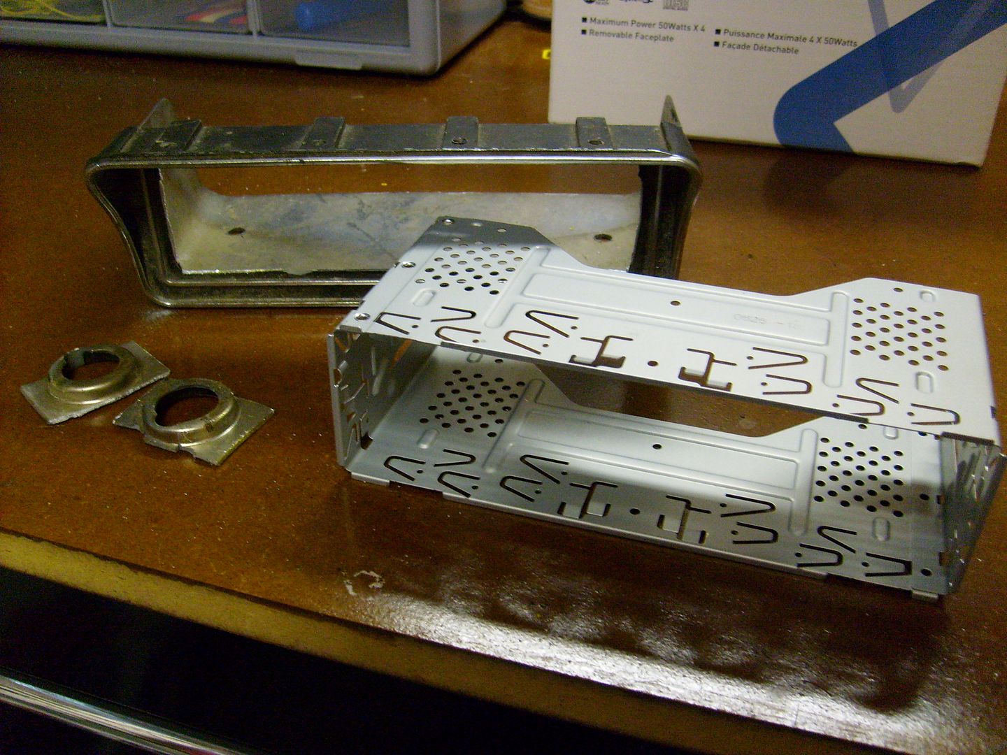

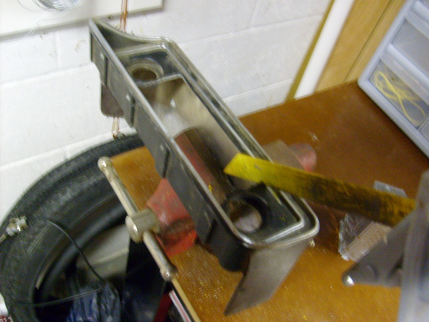

    So here's the 4 cuts I made.

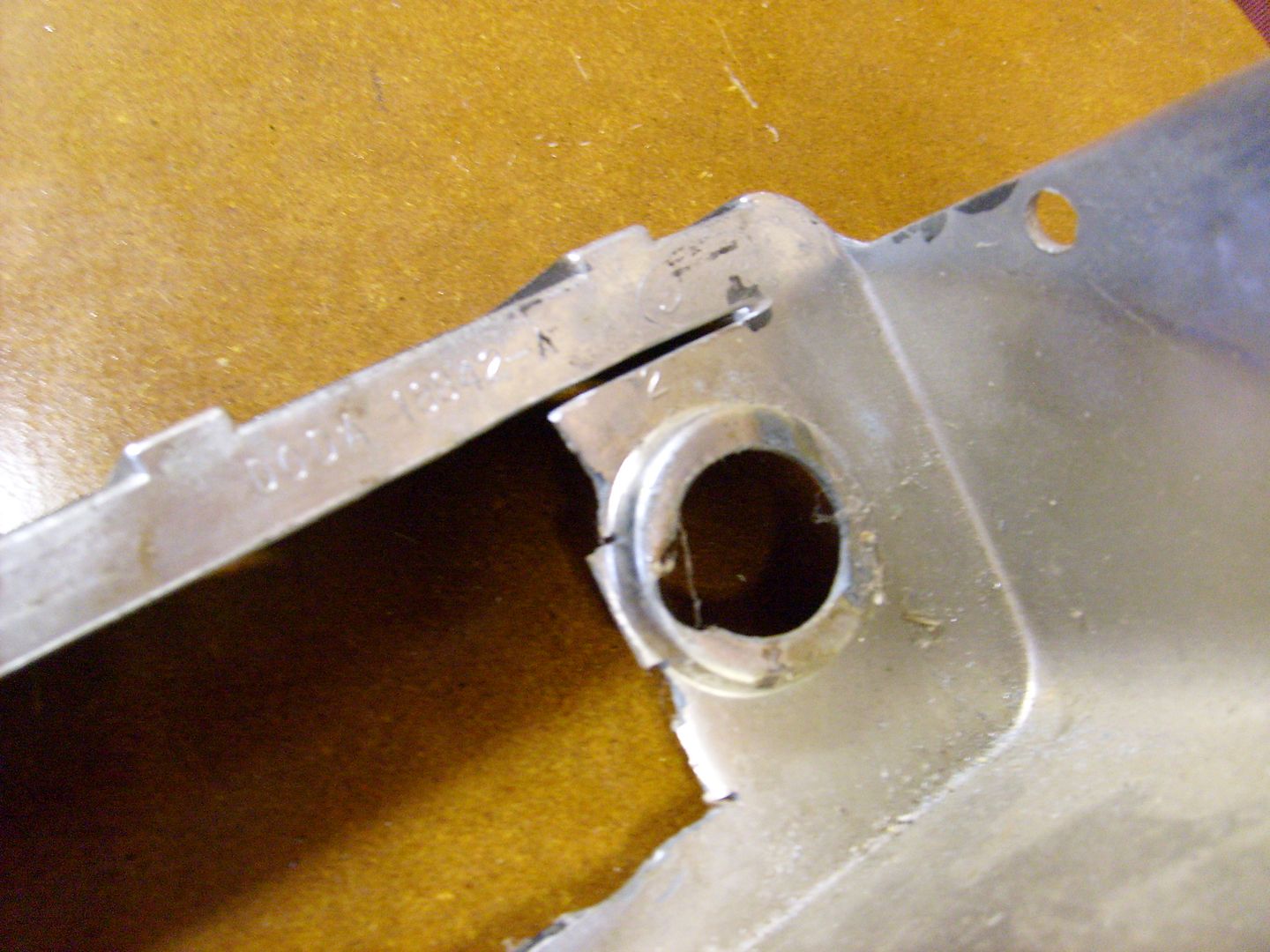

    I found that once again, the Dremel wouldn't really get it to make the cuts so I used it to score the ends as deep as I could. Then I used a large screwdriver to gently bend the parts I was removing back and forth till the broke along the line I had scored.
    So here it is. Next I have to break out the file and do the final fitting of the sleeve.

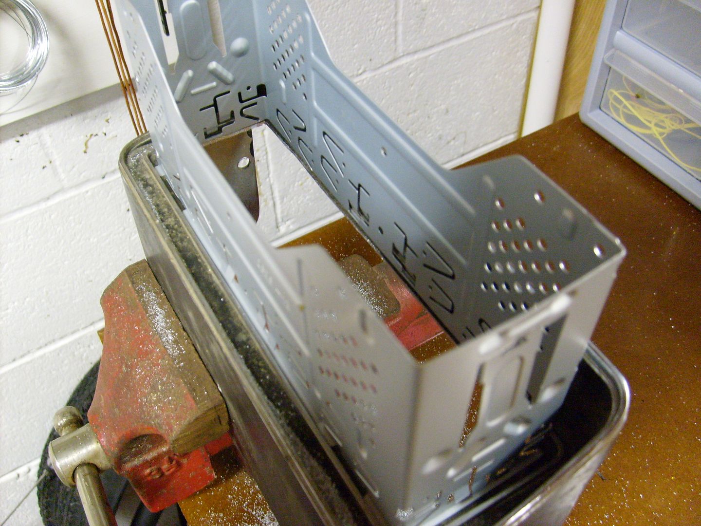

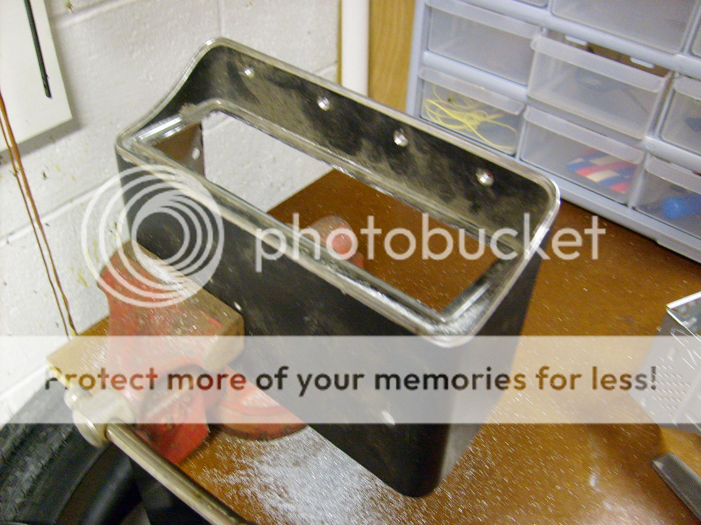

    I'm placing the lip of the sleeve on the outside of the mount to an idea about how much more metal I need to remove.

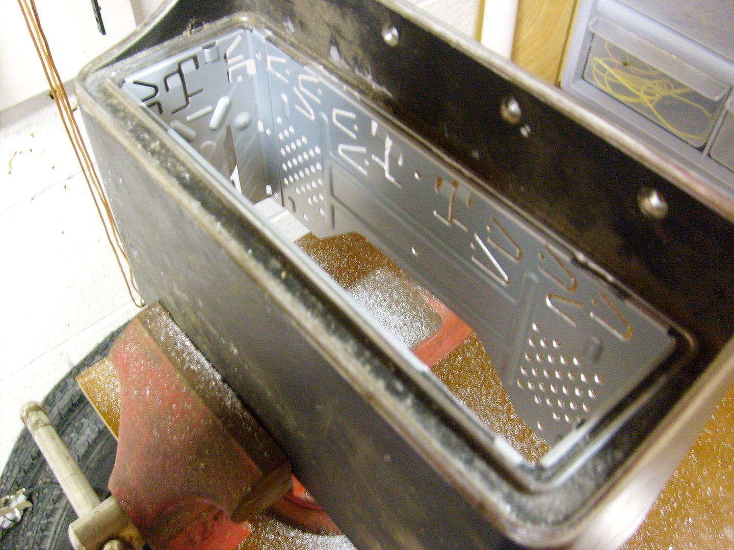

    Next I'm using a file to square up the opening and remove about another 1/16" all the way around to get the sleeve to fit. This takes some time but but be patient and the fit will be perfect.
    And here's the final result. A perfect fit. Actually much easier than I had thought it was going to be. Took about 1 1/2 hrs total. I'm gonna clean up the bezel and repaint it before I bend the tabs in the sleeve to lock it in. Then the new radio just slides in and locks into place.

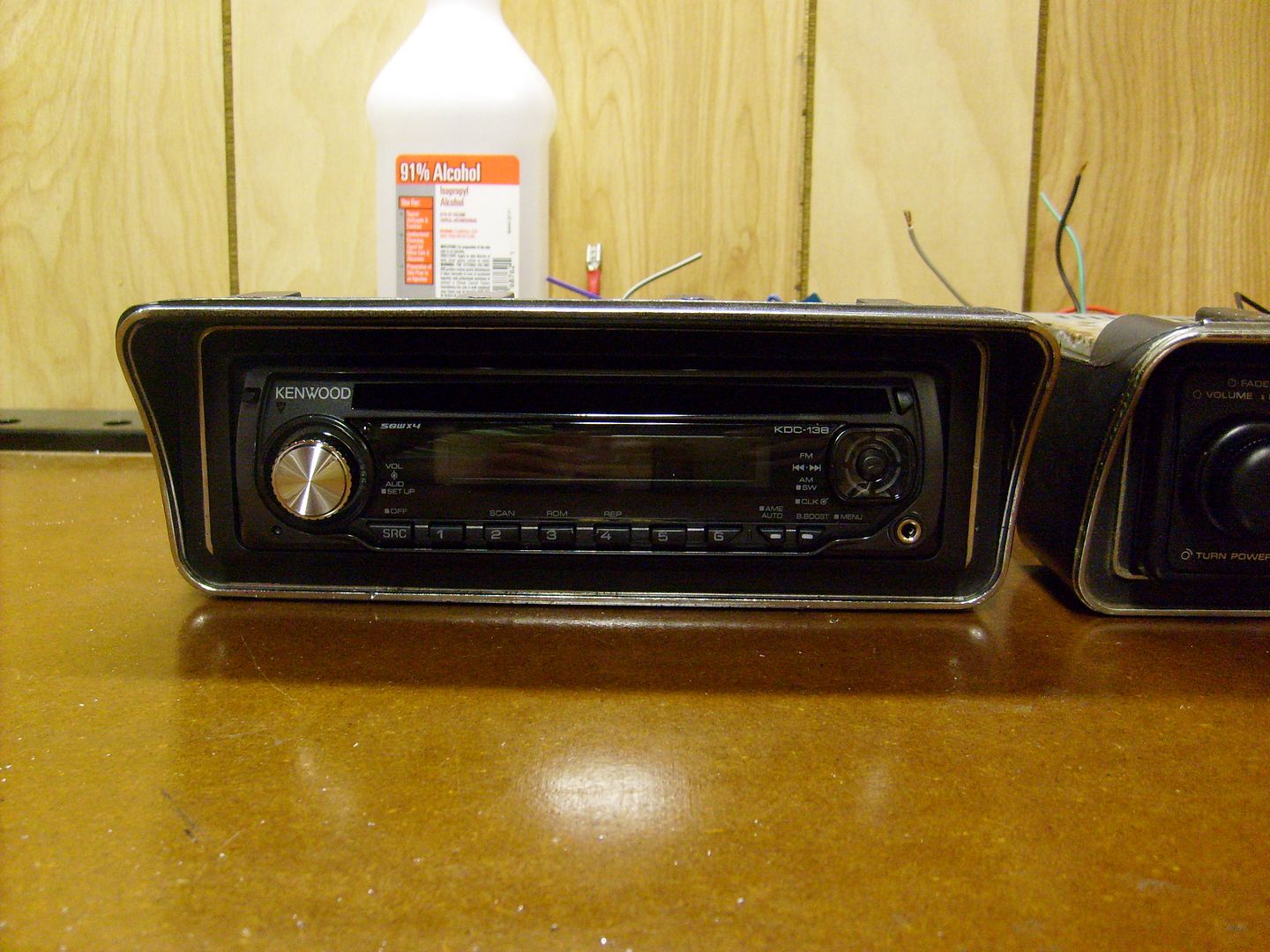

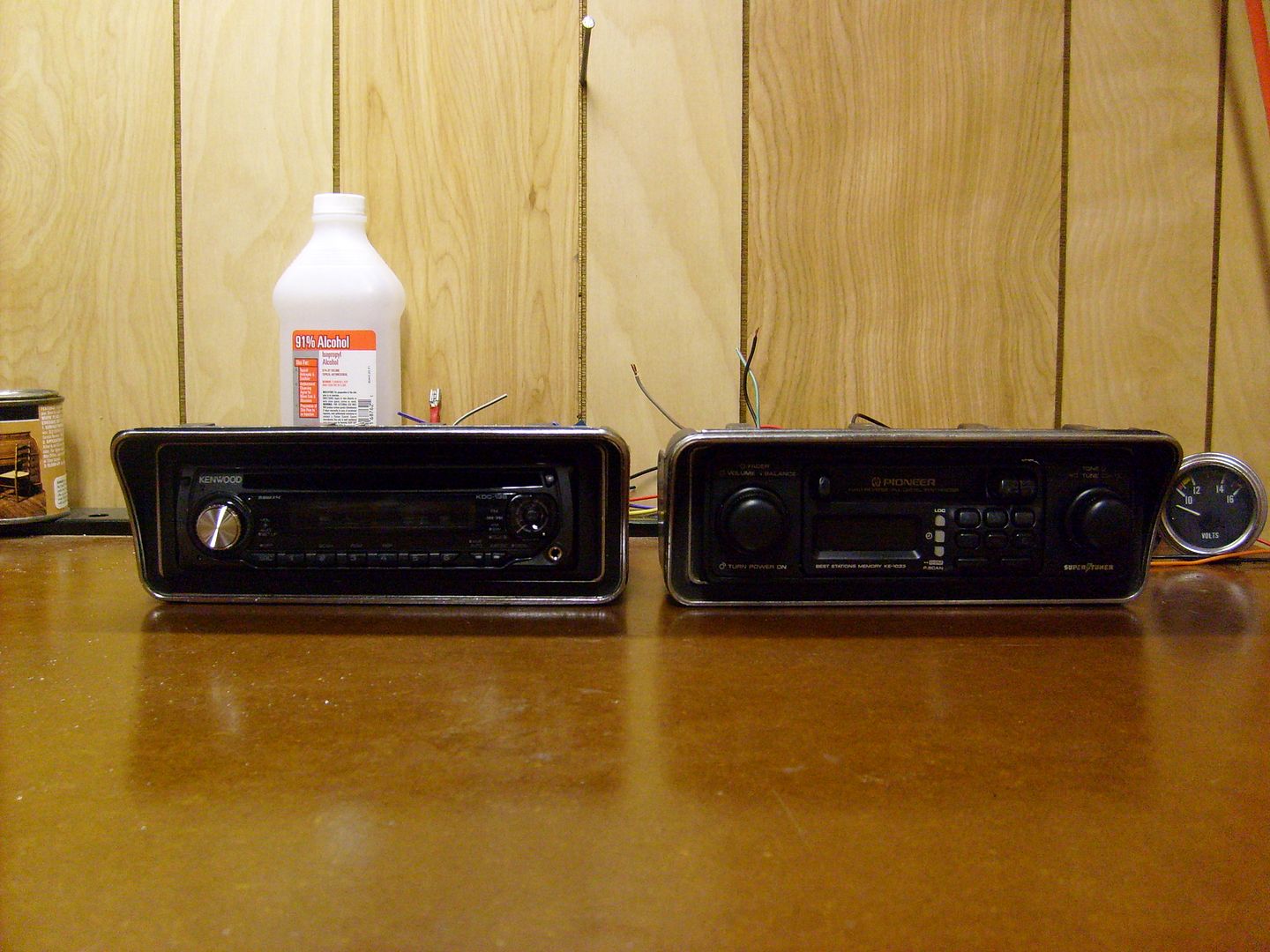

  10. predfan2001

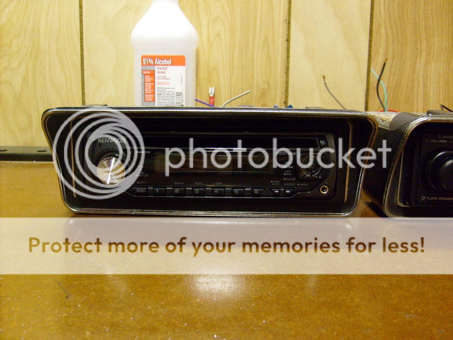

    The paint dried on the mount so I was finally able to get the radio in.
    With the old radio. I still like the 2 knob style....but the aux. plug in on the new radio will come in handy for an iPod.
