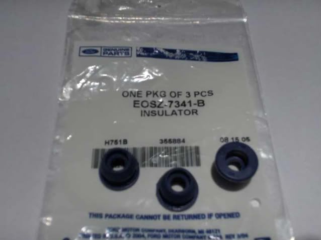

    Many thanks! So, this must be a fairly common part to fail?
    Just to make sure this is the correct part here's a picture:
  6. Dave B
    These are them, they press onto the shaft with a little work, then you have to press it into the hole on the flange. One of the old time mechanics at the dealer told me to put it in hot water first, then it'll soften it a bit and make it easier.
