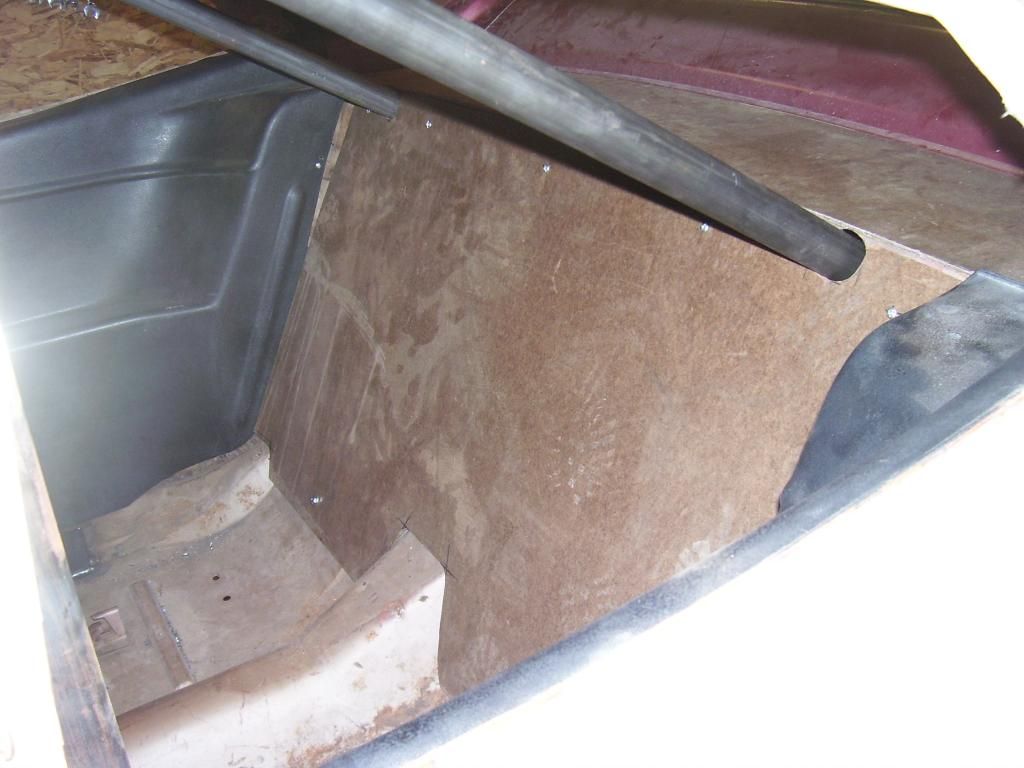

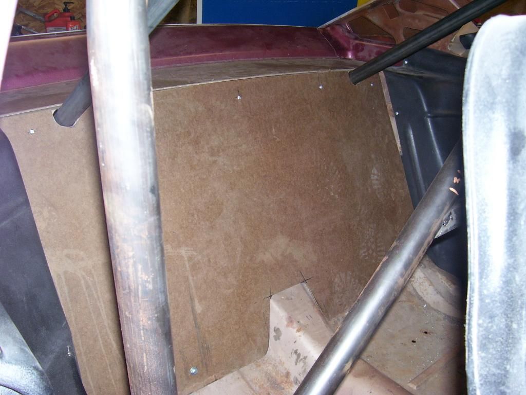

    I just make them out of Masonite then transfer that to aluminum.
    I won't have a rear seat to contend with. They will also be covered with carpet to finish them off and kill the rattles that sometimes come with mounting aluminum to steel.

    8,074
    962
    ^^ That is what they're talking about...but one made of metal instead of paper. The metal divider will keep the body from flexing. It's a race car thing.
