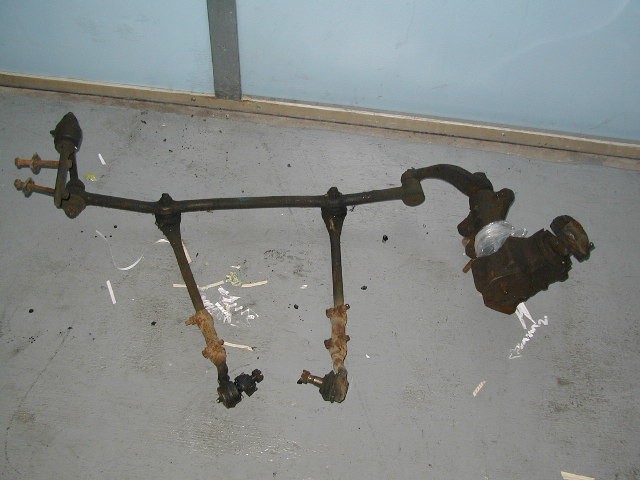

    I bought the entire front setup from Craig Selvey several years ago, and didn't even have to have it aligned! But i took the time to measure everything first, and got it pretty darned close upon reassembly.
