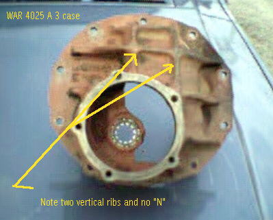

    If you can get a socket with extension onto the bottom bolts that hold the center section onto the housing, and get it straight on them, it is an 8". If there is 1 of those bottom bolts that will not line up straight and you need a regular wrench to get it out, it is a 9"
    This is another good site for info and pictures.
    http://www.kevinstang.com/Ninecase.htm

    That shield is used in both applications - 8 and 9 inch - just as in the above pictures.
    I'm not really following what parts you are looking at, but if you go to that web page in that post, it has a bunch of pictures.

    I think I know what you are asking about now. On the front of the 8" AND the 9" pinion there is a pinion support that rides in a bearing pressed into the case. The 8" bearing is smaller then the 9".
    Here is a shot of the bearing in a 9" case.
    And here is a shot of a pinion (again, both 8" and 9" have this support).
    I think the pinion you have is an 8.8" - they do not have this support as part of the pinion. Here is an 8.8" from ebay.
    I do have both an 8" and a 9" out and sitting in my shop right now, if you do need any other pictures. At the moment it is 6 below zero ( and that is not the bogus wind chill either) so my camara might freeze up, but I would try if need anything.

    ok.. i took the center chunk to the car wash and hosed it down... the bottom bolts ARE accessible... so it is an 8inch.. and the back of the housing is rounded with 2 dimples...
    yay.. now i just have to get the new gears...
    the ones i got seem to be 8.8 inch gears..

    Yes and no on this one. See Ford made like 27 different rear ends for their cars and trucks, and about half are variations of the 9" housing and center section. Some 9" have the hump and others are just plain rounded like the 8". Some have dimples, some do not. Axles are another whole thread - the whole 28 spline 31 spline, dimples vs slots, tapered and non tapered ....... you almost need a complete book just to cover all the variations ..... :huh:
