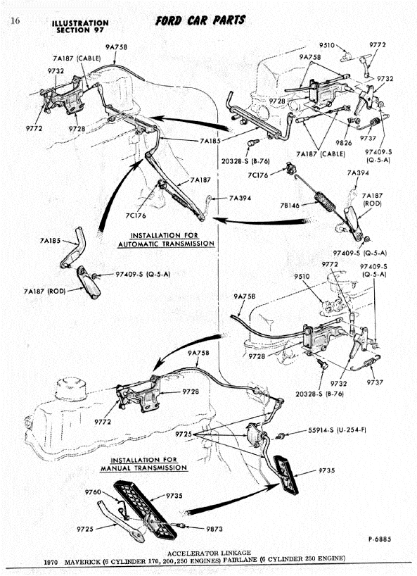

    I'm looking for some pictures or diagrams showing the throttle linkage setup (from the pedal to the carb) along with the C4 kickdown linkage setup for a 1970 200 cid. I know this was an odd year and have been searching for pictures online. It seems the website that used to have the diagrams (1bad6t.com) is down.

    Thanks! I appreciate the diagram.
    So, in 1970, which carburetor would have been used with the 200? A YF or the RBS?

    Does anyone have a passenger side view picture of the 1970 linkage actually connected to the carb? I bought the 1970 intake manifold bellcrank bracket with the short arm that goes up to the carb. I don't have a YF, but I figured with some modification to the short arm, I can make it work. However, when the bellcrank is pulled back (like it is when the accelerator is pushed), it throws the short arm forward quite a bit - too much to actually make the throttle arm on a carb go up like it should.
