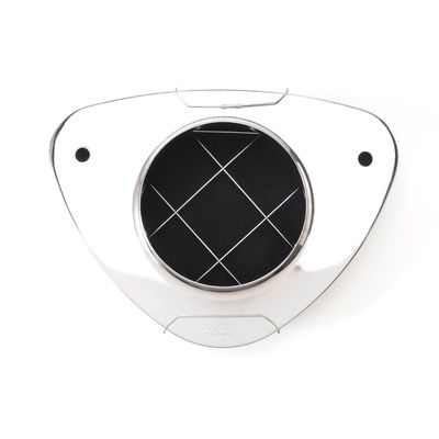

    What type of air filter is show on the second picture? Does that air filter clear the hood issue?
    The 'triangle ' air filter is easily modified tio almost flush with 2300 carb air horn
    https://www.summitracing.com/parts/edl-1002
    The Maverick hood is the lowest of any of the early Falcon platform Fords and is an issue to be figured out. A simple hole in the hood is fast and easy but 'snorkel' piping to an air cleaner is also possible if carb fits under hood.
    https://www.ebay.com/p/669144880?ii...MIuZrw0_OI6QIVFY_ICh2m0wn8EAQYBCABEgIeE_D_BwE
    [​IMG].

    That triangular filter is crap and I personally wouldn't run one again. I had one on a car in high school, one back fire will singe the foam allowing it to break free and get sucked into the engine. I honestly can't believe they still sell them.

    Considering high school was over 30 years ago they may have improved to foam since then too! Always seem to forget that, my mind still swears I'm in my 20's.

    I do not want to cut my hood. Is the air filter that you sent above (https://www.ebay.com/p/669144880?ii...MIuZrw0_OI6QIVFY_ICh2m0wn8EAQYBCABEgIeE_D_BwE) the same as the one pictured in the fordsix post? Will it clear my hood?

    I do not want to cut my hood. Is the air filter that you sent the same as the one pictured in the fordsix post? ... Will it clear my hood?
    Cant tell - to many variables , carb orientation ...
