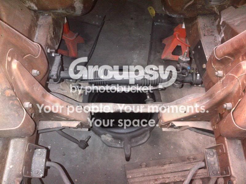

  11. Krazy Comet
    7,734
    2,441
    Apparently the hoses must squeeze between engine and LCA mount so route has to be something similar to this... I don't have the hose support in place but sure looks like with a different angle on the bracket, things would fit better...
    Does this taste familiar to anyone???
  12. 71gold
    2,935
    would you flip that pic for me?...:bouncy:
  13. Krazy Comet
    7,734
    2,441
    How about 90*?
  14. 71gold
    2,935
    ...:thumbs2:...:Handshake
  15. Dave B
    They go just above the lca mount.
