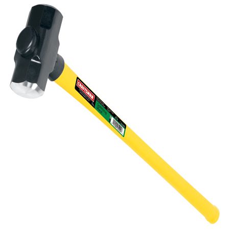

    Use a pickle fork, AKA, "ball joint separator." Also you will need a BFH and approximately 1/8 oz. of fresh, warm human blood. (Preferably your own, but substitution is permissible.)
