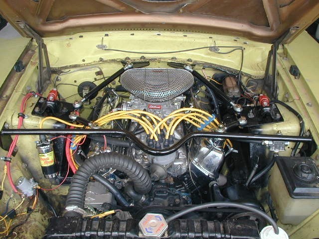

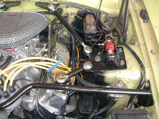

  6. scooper77515
    Monte Carlo bars...no more cut knuckles.
  7. mavgrab302
    Scooper, Did you make those your self ? they look really good....
  8. rayzorsharp
    Yeah, they look good...but where the hell does he put his tools when he's working on the engine??? :cry:

    Scooper, I just stole those pics. I've been thinking about doing something like that. You just gave me the pattern.. Thanks
  12. scooper77515
    That is why I posted them. They are on my website as well.
    I got those from fan2488. He made a set for me, and one a little bit different for Rick Book who uses EFI. I wouldn't bother asking him to make anymore. He said that the tools used to make them wore out after making each set, and cost more than the bars are worth.
    But yeah, the design is pretty simple and stiffens the front up quite a bit.

    very nice scooper, would like to have a set for EFI! I was really asking if the monte carlo bar could "replace" the factory braces as I also agree that something needs to be there. I'll probably try to do both. Can we get Rick and mavdog to post pics?
