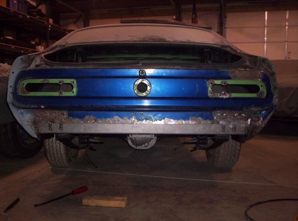

    this is in april 2012 when I finally got the newly narrowed 8.8 w/ discs under it with the 15x10 wheels under the back 265/50R15
    Gotta love the meats:yahoo:
    and that diff cover...lol

    What is the 8.8 out of and how much did you have to take off of it ?

    The 8.8 started out in a 98 EB Explorer
    and I stripped it of all the brackets and sand blasted it
    then took it to a local guy that owes the drag strip here and he narrowed it to 1" over all lenght less that my stock 8" rear end including the brake back spacing differance, so with the rotors on the axles its 1" shorter than a mav 8"
    I also bought and had him put on the new style torino housing ends on it for a c-clip eliminator, so now it uses the small 9" wheel bearings but the explorer brakes still bolt up

    Sorry don't mean to ask to many questions, do you happin to know off hand what the length is on a stock 8" is, backing plate to backing plate ?
    I put an 8.8 in mine around 98 or 99, it's out of a 92 Mustang, if i remember correctly it's 1/2" wider from leaf perch to backing plate on each side compared to the 8".

    If i'm reading my old notes right the factory 8" in my car was 51.5"
    from backing plate to backing plate and 56.5" from wheel flange to wheel flange

    I have another 8.8 out of a Couger, i wanna see how much difference there is between the Mustang, Explorer and Couger's there is or if they are all pretty much the same from plate to plate.

    I do know that the explorer is 59 1/16 from axle flange to axle flange
    and the pumkin is off set, so one side is longer than the other
    and is "longer" over all-i think, than the mustang & couger
    But explorers have 31 spline axles & usually lower gears(mine came with 3.73 and a limited slip)
    the guy that narrowed my housing took like 3" off one side and somewhere around an inch on the other to center the pumkin
