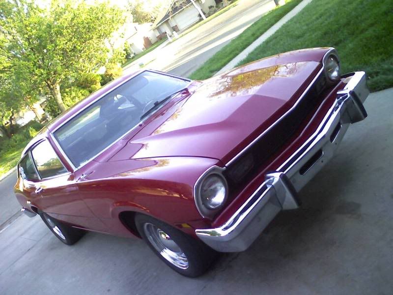

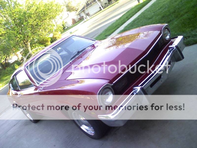

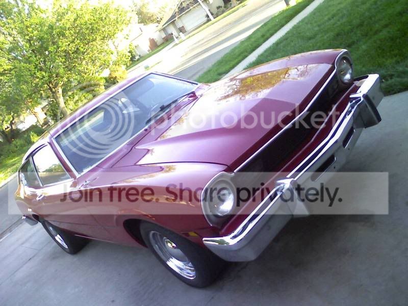

    btw.... post some pics of ur car sometime. i dont think ive seen it and it looks good in ur avatar
