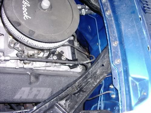

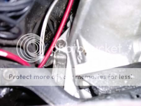

  4. elliot
    elliot Member
    Apr 12, 2003
    1,645
    Boubon MO
    76 4 door 347 paxton and t56
    Here is some pictures of how I did mine...
    Hope that helps ya a little.
