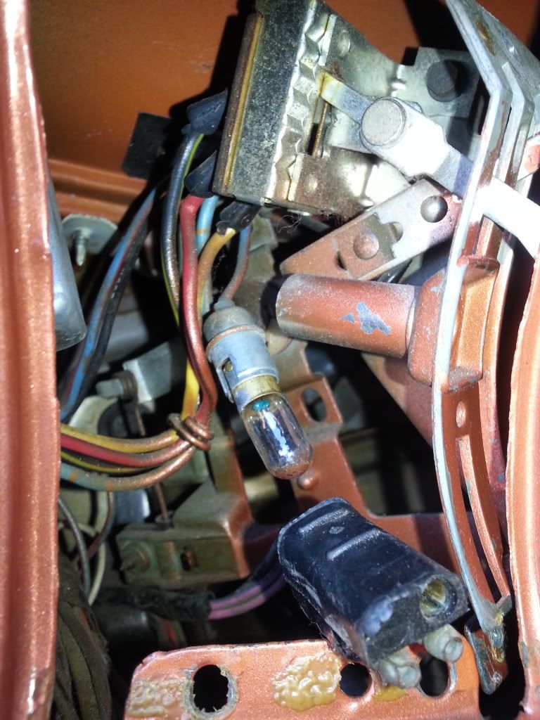

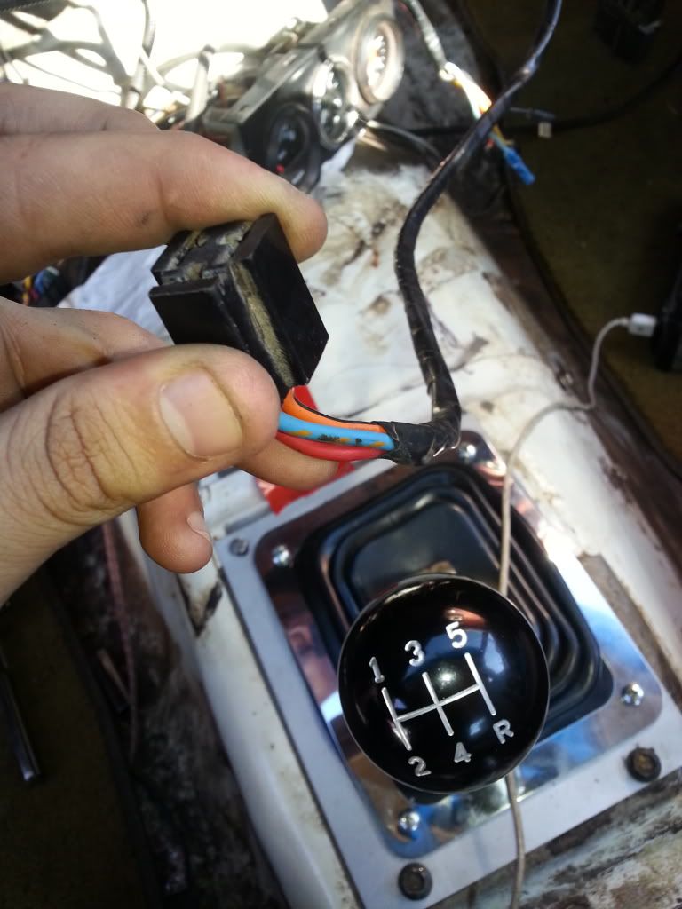

    I rebuilt my heater box and I installed it today. However when I hooked it up and turned the fan switch on it wouldn't start. The blower fan is grounded correctly.I took a jumper wire and ran 12 volts to the fan and the fan turns on. I tested the plug that goes to the heaterbox from the switch with a test light and didn't have any power.I tried following the fan switch wires but they lead under the dash Im guessing to the Fan On/Off switch. I unscrewed the heater control from the dash and it seems like the Fan switch is connected.The previous owner didnt have the heater working so I have no idea on how the system works.Does anyone know what the issue might be?

    With key on I have no power at these wires. I'm sure they connect to the switch.
    Is there any way that I can test the switch directly?
  11. Bryant
    it looks like their is only 3 wires in that plug.
    so im guessing those 3 goto the resistor block in the heater box.
    their should be a power feed wire that goes to the switch.
    you should be able to take your test light and check for power at the switch. you can put in on one of the posts that plug goes to and then move the switch to different positions and see if any have power.

    Yea those 3 wires plug into the heater box.So test them where they connect to behind the switch?And yes my car has an aftermarket ac disconnected.

    take your test light over to the fan switch by the head light switch and see if their is power there when the key is on.
    also i think there was a fan switch in the old ac vent in the center of your dash. the problem may be that switch is part of the system now.
