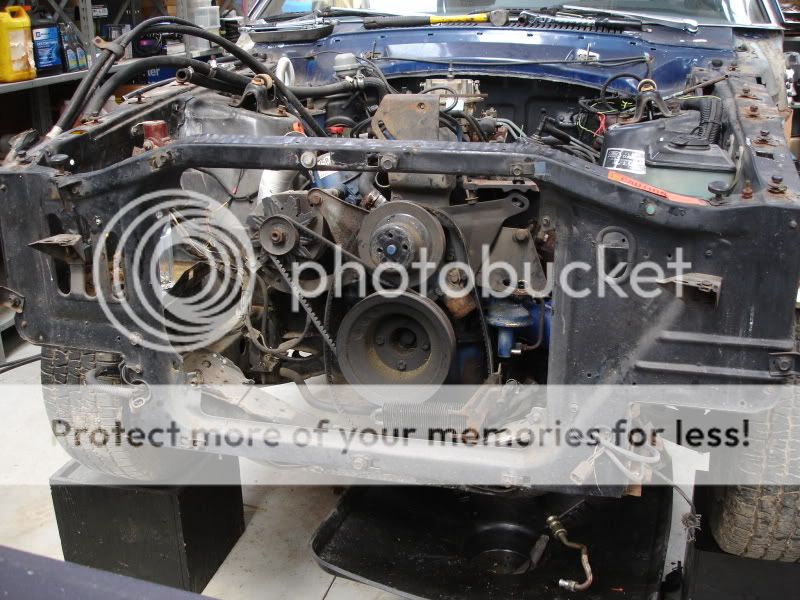

    Here is a picture I took before disassembly. If you have a 302 with PS and AC, it might help you.

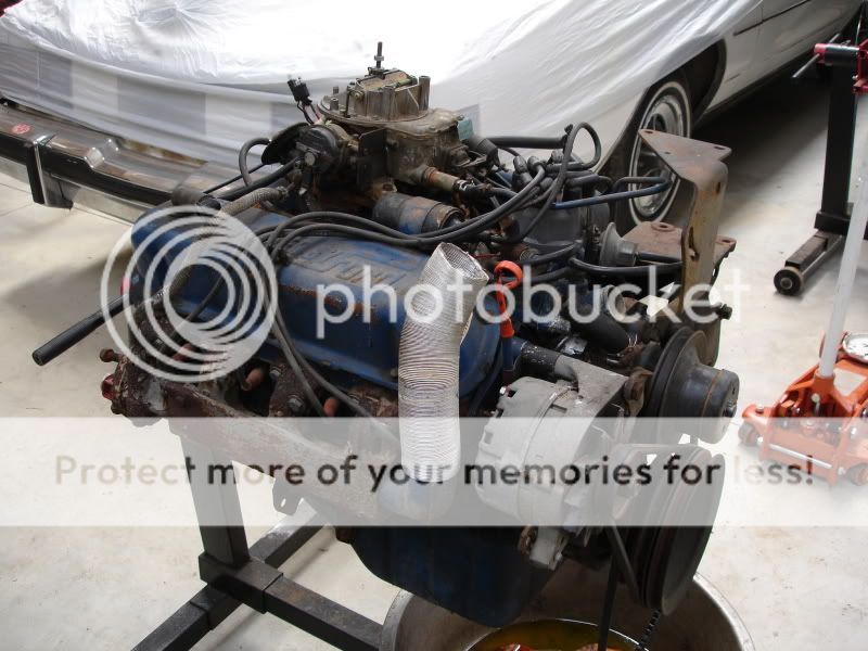

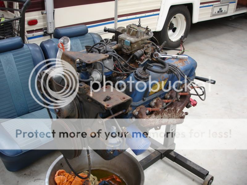

    Here's a few more if it helps.
