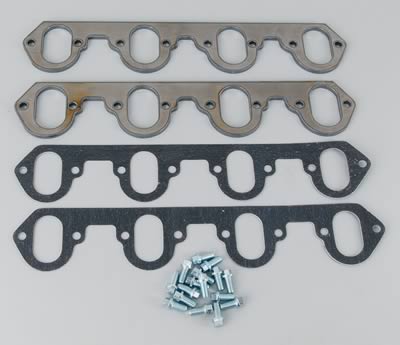

    Buy a blank flange, and have that welded to the header flange, and pick up an extra 3/8" or so.
    I used one on that one side with a gasket on both sides to help get some space. Would have been easier if it was welded to the header, so I wasn't juggling a header, two gaskets, a flange, and a bolt during installation.

    I'm worried if I put another flange in the headers won't clear my shock towers.
    The lower tube on that side contacts the lower part of the shock tower where its more or less the motor mount bracing.
