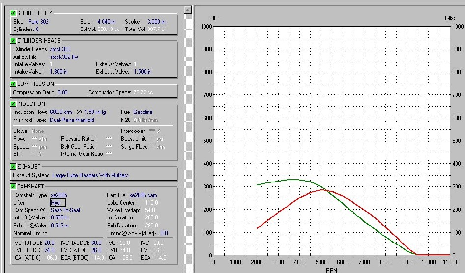

Don't know if this is "exactly" right, but I think it's pretty close. For a 2 bbl, I'm impressed. If anyone sees a mistake, let me know. Here you go................ Country
Looks good, Country. Did notice a mistake, though...i don't know what heads you have, but i'm sure you have the intake valve too small. 1.70" or so intake valve is usually about as small as the SBF heads go. 1.40" exhaust might be right, but could be larger too.
Thanks, I wasn't sure on that, but I would rather have undershot myself, than overestimate. I'll fix it, and see what results I get. Prolly a small change at least................Thanks, Country
Think this is about right. Correct me if I went to big, but my heads have been ported and polished and shaved. So I dunno how much they flow.........Thanks..........Country Horsepower 289 Torque 311 Changed the intake to 1.80 and the exhaust to 1.73 Country
how this look from your side info says yours is 40 over you have 60 in the program and your cam is a Comp cams 268 ?
Yes sir....... But my buddy messed up and put in a 600 cfm dual plane intake I only have a 300-350 cfm stock intake. I would imagine I am gonna suffer some losses there. If you could send the files, and explain how to use them, I would appreciate it. Thanks for your help, Country
