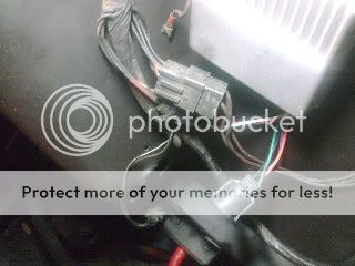

    Also on the ignition module has anyone else had this problem:hmmm:
    There was only one of the two connectors on the replacement that had the wiring in the car, what does the other wiring on the module run to?

    One plug goes to the harness and the other plug goes to the distributor.
