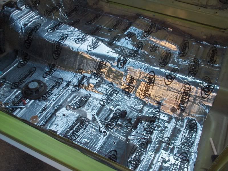

  14. Dave B
    I used 2 boxes, but I did everything, the wheel wells, the roof, the firewall, cowl, everything I could.
    This is about half way:
