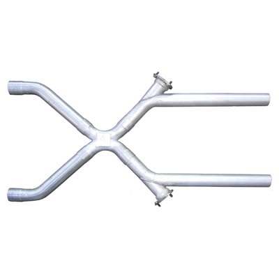

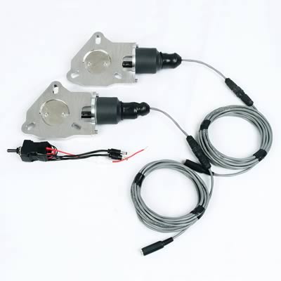

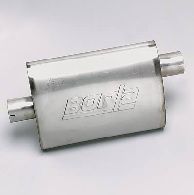

    Every exhaust system is like a science experiment. If I was in your shoes I would try this: 3" mandrel bent into a Dr.Gas X-pipe - 3" inlets x 2.5" Outlets. into 2.5" stainless Borla Performance turbo mufflers. I would keep the side exits. That would be worlds quieter, still have a nice tone, and I would bet anything you would actually make more power. The x will easily compensate for the reduction to 2-1/2" mufflers. And to make it even better, install electric cut outs between the X and the mufflers (so you still benefit from the x). Then you will be L.O.D. (LOUD ON DEMAND!) As long as you are paying for it I might as well make it the best!

    those electric cut outs are bad ass, i was going to get a set you have you manually open for my olds. that is when i get an exhaust on lol

    H-pipes quiet the exhaust. Especially when sized the same as the main pipes.
    X-pipes tend to increase sound.
    If you are concerned for your neighbor, I would put a 3" H-pipe and run 2.5" to 3" (if you can) pipes out the rear.
    After those two mods, I think you can say you have done everything reasonably possible. Afterall, you don't want him to cause you to buy new mufflers, that is unreasonably expensive. Especially considering that you are legal just the way you are. If your car is legal for the public roads, he doesn't have a leg to stand on at your home... unless you backed up to his bedroom window at 3am and gunned it!

    Go on the F-body or late Stang boards... It's common knowledge that sound is not tamed for those with X-pipes.
    Also, that quote sounds like a commercial.
    I read an interview with Dr. Gas himself, forgot his proper name...
    Anyway he pretty much said bluntly that X-pipes are only good for about a 2-4% power increase at 8 or 9000 rpm on open exhaust Nascar engines.
    He said that he was going to sell them to anyone that wanted them, and the producer (he sold the concept to) has plenty of sales hype, but that he sees little gain when they are put on street engines.
    So if you have a 9k rpm, open exhaust Nascar engine, they are worth it.
    He said that Nascar teams regularly spend big dough for tiny increases that don't mean squat on the street.
