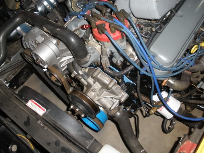

I used this setup (not my motor) on my grabber. You have to open up the tensioner flip the spring and drill a new hole for the spring. Stock mustang setup
