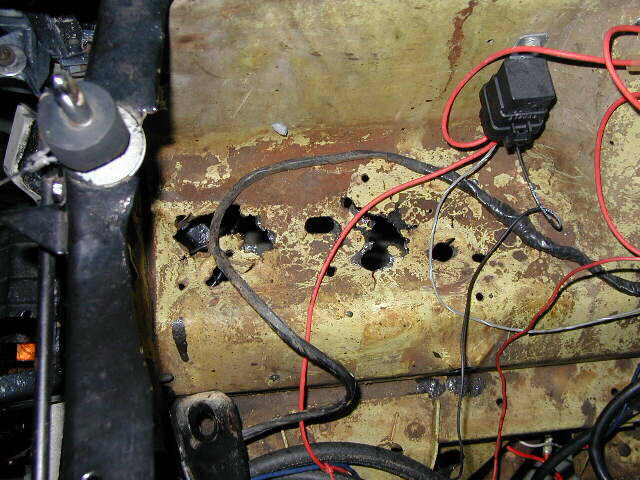

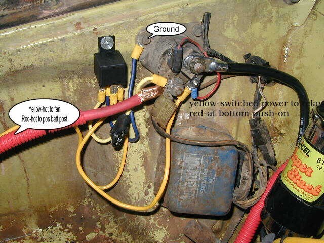

    Before I did my electric fan setup, I just popped the belt off and drove it around the block...it really is a pretty noticeable difference (that was mostly stock motor).
    Run the fan off a relay, preferably one that is tripped on and off by the temperature of the water.
    Pics and description at my website...http://scooper77515.fordmaverick.net/august2005.htm
    Relay wiring...
    And temp relay...
    Some may not like the extra wires all over the place.
