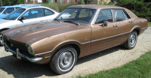

    Wow...I can't believe that used to be black. How many coats did it take to make it white?
    I see the stock number is still written on the part: 72j
    That means it came off of this car:
    That was probably the ONLY good part of the interior. It was really trashed!!
