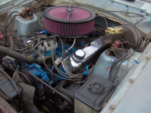

  14. maverick75
    9,018
    How big is it? My 14"x4" cleared fine.... [​IMG]
  15. maverick75
    9,018
    And if you want to run a factory air cleaner you can get one with a provision that clears the DS cap :)
