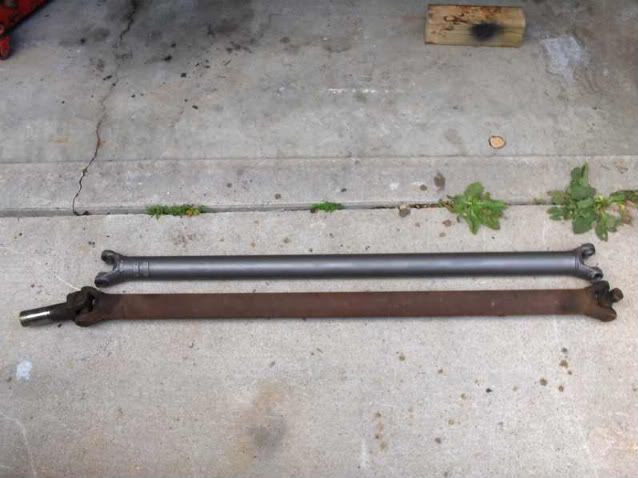

    If you're questioning my post, here's a little background: My 77 Comet was converted to a V8 by some previous owner. The driveshaft that came with it looked to be the puny one pictured above. When I swapped the 331 in, I swapped that shaft with a bigger one from a 68 Stang. It truned out to be out of round at the back end. I bought a 2002 Stang shaft off ebay that measured 45.75" ctr to ctr. This was .25" longer than the other two shafts I had (both the Comet shaft and the 68 Stang shaft were 45.5" if I recall) One inch either way usually doesn't hurt anything, unless the shaft you're replacing is too long or short to begin with. The 45.5 shaft was a tad on the short side for mine, I wasn't comfortable with the amount of slip yoke that was into the tailhousing and went to a longer yoke and the slightly longer 2002 shaft.

    :16suspectDon't misinterpret the "questioning" part. Probably a poor choice of wording on my part.:hmmm: Just wanted to clarify the length capability of driveshafts in our cars. There's some room for plus or minus at least an inch of length in searching for driveshafts.
