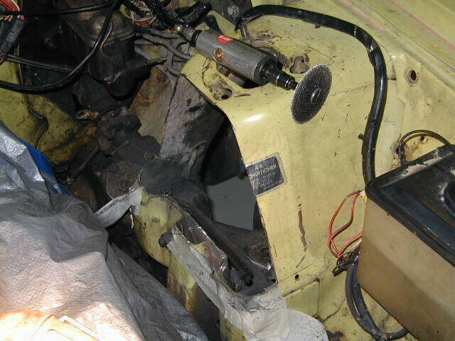

    Here is how I did mine...
    I went in another 1/2" more than most, but it still doesn't get into the header tube area.
